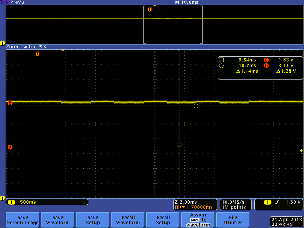

I tried to run USART code outside of RTOS. Definitely i dont have any other ideas. Now it doesnt matter if USART1 was used or not. On USART3 RX pin signal looks like its permanently pull-upped.
EDIT: Code optimizations are off. I tried to use different versions of code sourcery toolchain. Also i tried to combine USART1 & USART2 and USART2&USART3. Everytime with the same result.
STDPeriphLib v3.5.0
EDIT2: I forgot to say when USART3 code did not run within RTOS. IT RXNE was never fired.
This is image of USART3 RX Pin - Without RTOS. If code run within RTOS and USART1 TX was called, USART3 RX Pin looks same like image above. If USART1 TX not called, signal looks normal.
Posted on April 22, 2013 at 01:09
Doesn't look like a valid signal, hardly surprising RXNE is not asserting.

Of course it isn't. And I know that this signal is a reason why RXNE was never asserted. But how did i say before, if i dont send any data over USART1, USART3 works great.

USART3 RX:
Posted on April 22, 2013 at 13:14
Ok, then perhaps we should be looking at your hardware and not the software. Suggest you describe the chip and board you're using, ideally with a schematic.
It could be related to software you haven't listed. You could simplify the implementation to the minimal code to demonstrate the failure, and provide a complete example.
