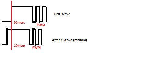

this is my code:
I'm working with STM3220G. I have to create a project that: configure GPIOA(pin1) in output for 20msec. After 20msec, starts a PWM for 5msecand so on... My problem is: when I see in myosciloscope, the waveform are not aligned. The situation is:#include <

My problem is: when I see in my oscilloscope, the waveform are not aligned.
They are not aligned with respect to what?
Options
‎2013-07-15 11:10 PM
Posted on July 16, 2013 at 08:10
Hi Clive1,
in fact not aligned is wrong. The problem is to synchronize the waveform, that is after n steps (random) the waveform moved. where is the error? Must I set timer in other way? Must I set the systick in other way? THANKS!.
