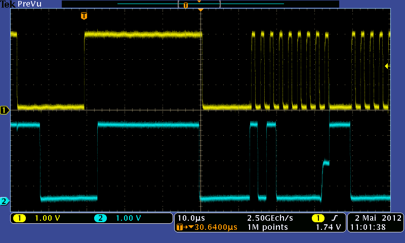

I share a screen of a result of my code in my oscilloscope. Ther is an strange thing between my start and a adress send, i don't know why i have this attent time, and an other strange thing, it's my ACK it's not 0 but not 1 it's between the both. I've testes for twot EEPROME ( the m24lr64 and m64c64) the result are the same. Anyone can help me, or have this same problem.- Mark as New
‎2012-05-04 5:20 AM
try configuring the pins in open drain mode
‎2012-05-04 6:22 AM
thank you ver much that was the mistake in my code.
