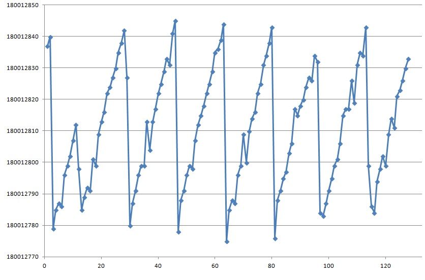

Hi! I try to measure GPS PPS (pulse per second) duration by TIM2. Setting code:
TIM_TimeBaseInitTypeDef TimeBaseInitStruct;
TIM_ICInitTypeDef ICInitStruct;
TimeBaseInitStruct.TIM_Prescaler = 0;
TimeBaseInitStruct.TIM_ClockDivision = TIM_CKD_DIV1;
TimeBaseInitStruct.TIM_CounterMode = TIM_CounterMode_Up;
TimeBaseInitStruct.TIM_Period = 0xFFFFFFFF;
TimeBaseInitStruct.TIM_RepetitionCounter = 0;
TIM_TimeBaseInit(PPS_IN_TIM, &TimeBaseInitStruct);
TIM_SelectInputTrigger(PPS_IN_TIM, TIM_TS_TI1FP1);
TIM_SelectMasterSlaveMode(PPS_IN_TIM, TIM_MasterSlaveMode_Enable);
TIM_SelectSlaveMode(PPS_IN_TIM, TIM_SlaveMode_Reset);
ICInitStruct.TIM_Channel = TIM_Channel_1;
ICInitStruct.TIM_ICPolarity = TIM_ICPolarity_Rising;
ICInitStruct.TIM_ICSelection = TIM_ICSelection_DirectTI;
ICInitStruct.TIM_ICPrescaler = TIM_ICPSC_DIV1;
ICInitStruct.TIM_ICFilter = 0;
TIM_ICInit(PPS_IN_TIM, &ICInitStruct);
TIM2 clk:180Mhz. In interrupt value of CCR1 stored in array. Result: 0690X000006038gQAA.jpg What caused this behavior?I apologize for not being word-perfect in English)

The description of the issue is not clear enough . Please share the hole Timer initialization code and related main function parts.Which input pin you are using (PA8 ? PE9?) and pin configuration ?. Have you configured the NVIC for timer interruption ?
The hardware you are using and if there is any external connections ?
-Hannibal
Posted on April 20, 2016 at 12:09
I believe it is showing you the frequency and drift rate of the receivers local clock wrt the PLL clock.

I use Stm32f429 Discovery. GLONASS receiver MNP-M7, but if measure pulse from AGF3022C result exactly the same.
Posted on April 20, 2016 at 13:00
You see the saw tooth on your other equipment? The output is the same as what?
I don't see a specification for the rms error in the 1pps. I'm thinking it is not very tight. What clock drift and bias measurements is the receiver outputting with respect to the local clock?

I also use Tektronix AGF3022C to generate PPS and  got the same saw tooth in debug array.
Posted on April 20, 2016 at 17:55
I can't explain why the AFG3022C would give you the saw-tooth profile.
What is clocking the STM32F429?
I might try to replicate this with a Nucleo-144 F429ZI and an u-Blox M8N later.

Ok, so had a F446 to hand, 180MHz, APB1/TIM2 running at ~90MHz, measuring 1PPS from u-Blox M8 receiver.
89998948
89998945
89998945
89998947
89998945
89998945
89998945
89998947
89998945
89998947
89998945
89998945
89998945
89998947
89998946
89998945
89998947
89998945
89998945
89998947
89998945
89998946
89998947
89998945
89998945
89998947
89998946
89998945
89998948
89998945
89998946
89998947
89998945
89998945
89998948
89998945
89998946
89998947
89998945
89998946
89998948
89998945
89998946
89998947
Varies perhaps 4 or 5 cycles, not saw-toothing over 70

Reviewing the number of seen satellites and quality of reception might be helpful. The accuracy of the PPS will surely degrade with fewer satellites.
