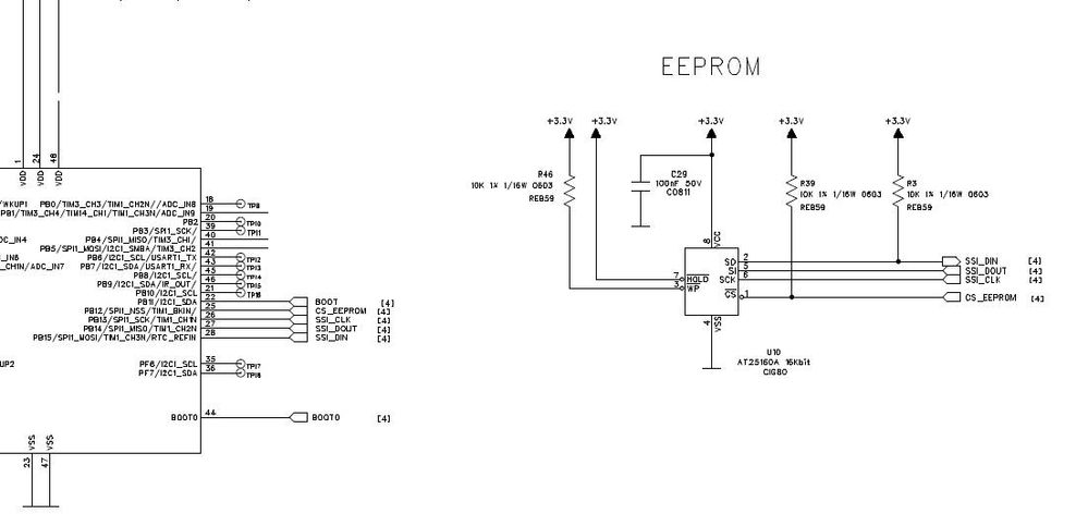

the my problem is comunication with SPI.

I ask you if this configuration is correct!
The use the SPI for comunication EEPROM with the following schematic:
Thanks
4 REPLIES 4
Posted on September 04, 2014 at 11:16
The Input/Output sense seems backward. Wouldn't MOSI need to go to SI?
u23
Senior
Posted on September 04, 2014 at 14:09
Exact!
I invert the pins and verify the source code!
Thanks

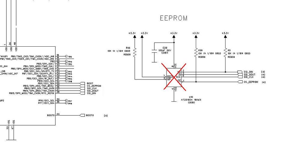

Posted on September 04, 2014 at 16:23
I eliminated the EEPROM device in schematic.
I send the char with SPI and monitoring the signal in output from microcontroller.
SSI_CLK --> is low;
CS_EEPROM  --> is  low for 100 ms (
duration
of
transmission of the
given
then
back high for 500 ms;
SSI_DIN --> is low.

Why the CLK signal is absent?
Help me!
