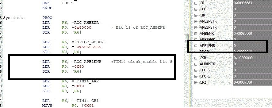

I am now initializing TIM14 following code does not copy to the actual registers at the debugging RCC_APB1ENR EQU 0X4002101C Other registers are showing very correctly but timer 14 related registers should not show the values at the debugging
LDR R6, =RCC_APB1ENR ;TIM14 clock enable bit 8
LDR R0, =0X80
STR R0, [R6]
Posted on December 12, 2014 at 21:09
I'm not sure what peripherals are present in your particular chip
LDR R0, =0xFFFFFFFF
STR R0, [R6] ; Set all
LDR R0, [R6] ; See which stick

Posted on December 13, 2014 at 02:00 Dear Sir, I am using STM32F051R8 It is stranger to me, following code works
LDR R0, =0X11
STR R0, [R6]
But this code is not working
LDR R0, =0X80
STR R0, [R6]
Only code different is 1.
LDR R0, =0X11
2.
LDR R0, =0X80
So, I would need second one which is used to enable clock for TIM14 by setting bit 8 of APB1ENR
