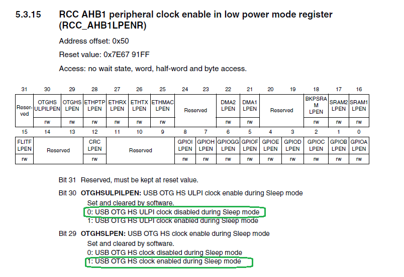

Posted on December 15, 2012 at 18:43
Dear all,
Thank you for posting this interesting issue, Here I give the details of the behavior and THE solution :
This unwanted behavior is caused by bit ''OTGHSULPILPEN''  that is  set by default in register AHB1LPENR  ( See below) , reset state is [1].
When working with our High Speed peripheral in full speed mode and you want to enter SLEEP using WFI cortex-M low power mode,  the firmware side  should configure these bits in this way :
1) Clear bit
OTGHSULPILPEN
2) Set    bit  OTGHSLPEN       in register  AHB1LPENR  ( already set after reset)
Hope it helps you.
