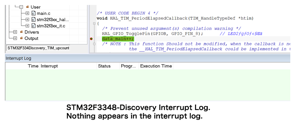

Interrupt not displayed in interrupt log in EWARM.
I made a program to toggle the LED every 0.5 seconds by TIM 1 overflow interrupt, using  STM32F3348Dicovery and STM32Nucleo-F401RE. The picture below is part of the program and the interrupt log.
An interrupt is displayed in the STM32Nucleo-F401RE interrupt log. But Nothing appears in the STM32F3348-Discovery interrupt log.
Why?

Look at the IRQ Handlers, likely have different names, they call HAL code that in turn calls your call-back code. Check the vectors and startup code.
Not sure if IAR has a forum, or FAQ, you should check their support options.

Posted on November 07, 2017 at 07:02
Thank you for your reply.
I'll ask IAR.
