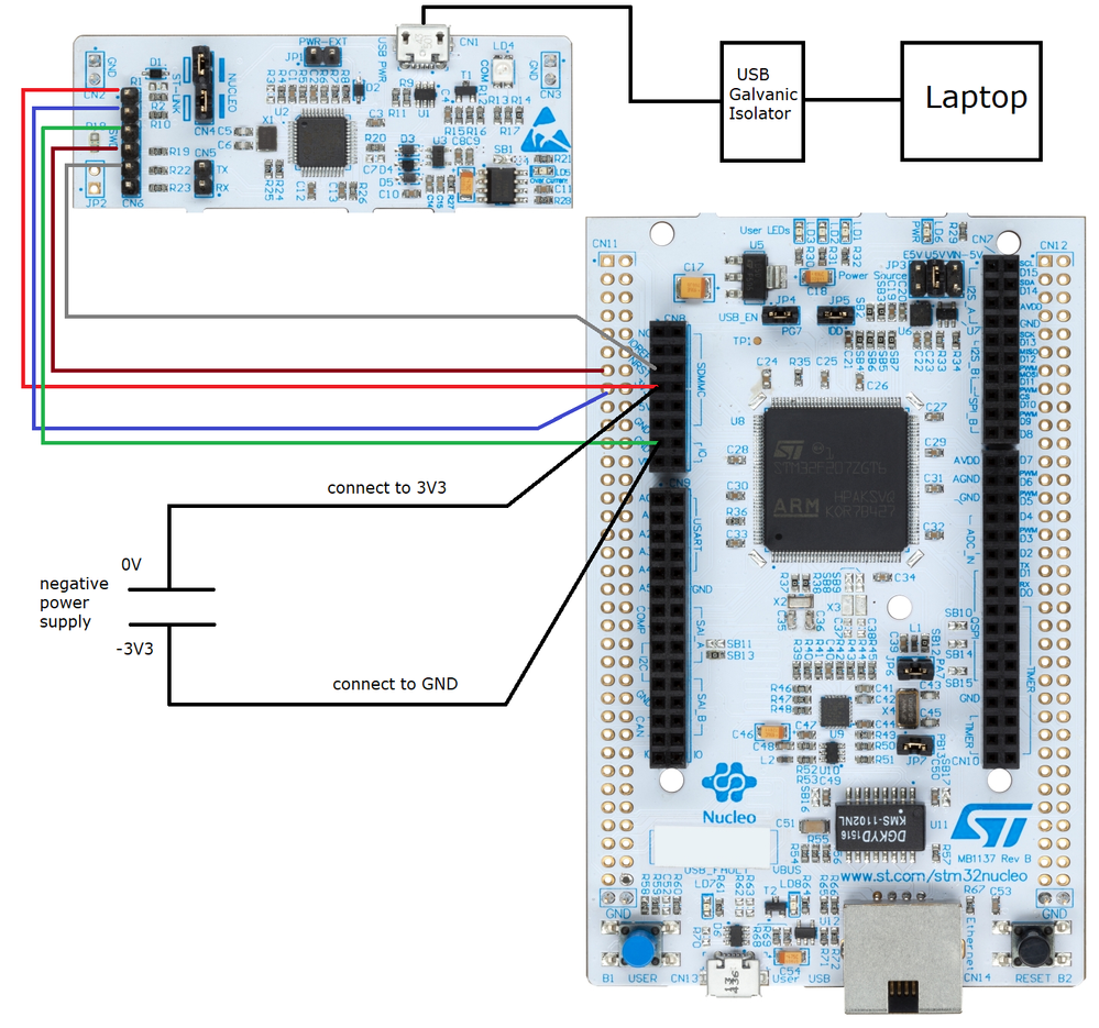

How is it possible to power the Nucleo-144 board with an external NEGATIVE power supply (VDD= 0V, VSS= -3v3)?

Voltage is relative. As long as VDD - VSS = 3.3V, it will work. However, if you have other things connected to the board that think VDD = GND, you're going to have issues.

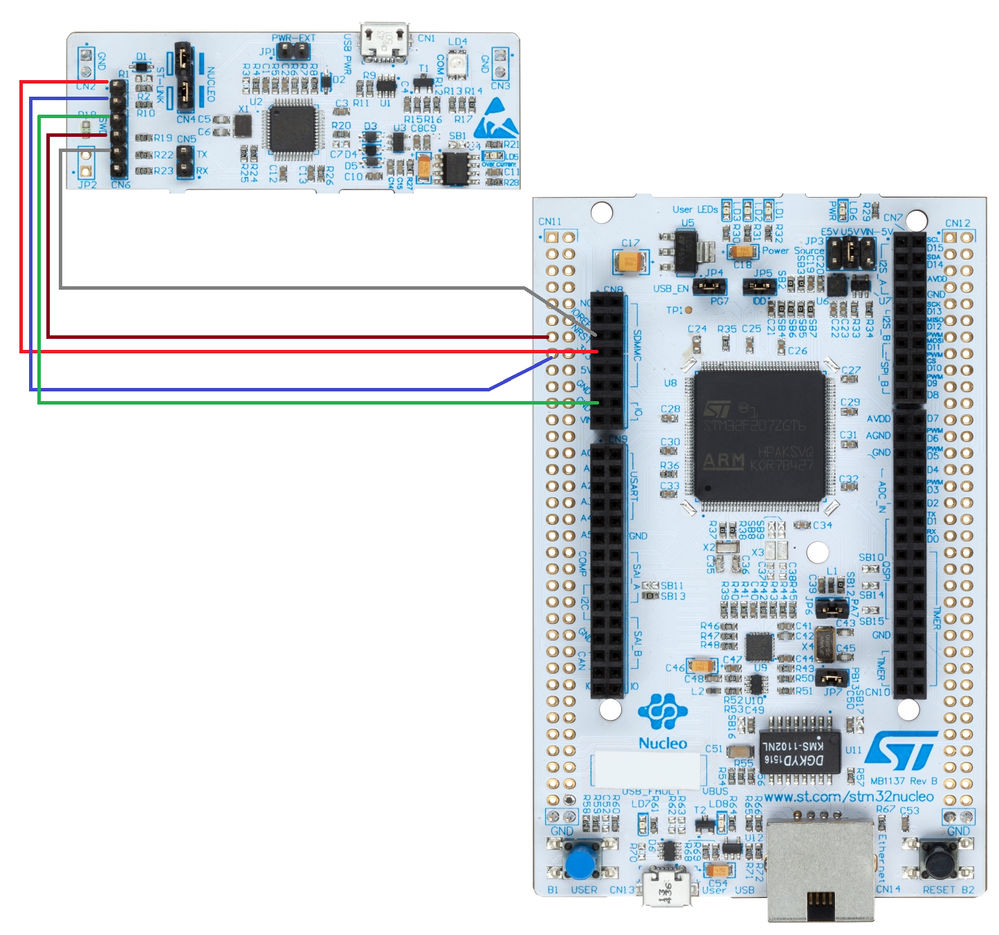

So my question is: If I cut the ST-LINK/V2-1 PCB from the board, is it possible to use the ST-LINK/V2-1 (removed) to program and debug the same board (I removed from)?
According to Table 5 (page 22) and STM32CubeMX:
VDD_TARGET --> 3V3
SWCLK   --> PA14
GND    --> GND
SWDIO   --> PA13
NRST    --> NRST
Is it correct to connect the pins as shown in the picture?
Yes, it is. Note that the programmer and the board will need the same ground. I'm unsure if SWDIO/SWCLK are broken out into pins somewhere, but provided you can get at those somehow, you can program the board.
0693W00000Bbc4OQAR.pngI made the connections as shown in the picture. LD4 and LD6 are turned ON.
I tried to run a test program on the board.
I chose the "GPIO_EXTI" from the repository (..\STM32Cube\Repository\STM32Cube_FW_F4_V1.25.2\Projects\STM32F429ZI-Nucleo\Examples\GPIO\GPIO_EXTI).
After running the program, the microcontroller fails on "HAL_RCC_OscConfig(&RCC_OscInitStruct)".
The same problem if I choose another example from the repository.
The clock source used in that example (and probably others) comes from the ST-Link, which you've cut off, so no clock source.
https://github.com/STMicroelectronics/STM32CubeF4/blob/master/Projects/STM32F429ZI-Nucleo/Examples/GPIO/GPIO_EXTI/Src/main.c#L111
You'll need to modify it to use the internal HSI instead.
