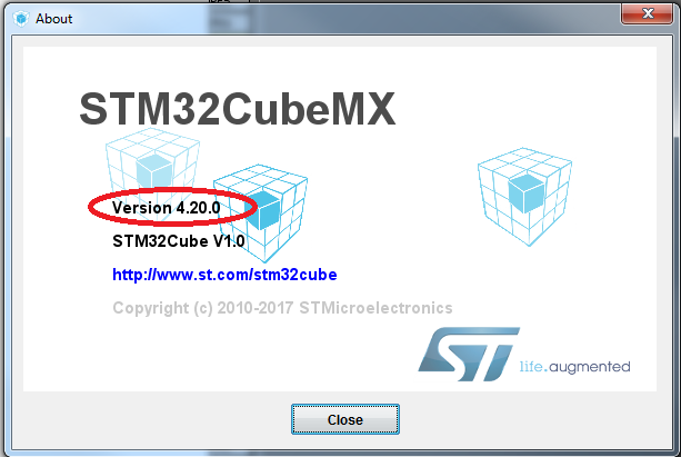

My company's proxy server is configured using a script which prevents my STM32CubeMx software from accessing the http servers for updates.
I have downloaded STM32CubeL4 firmware version 1.7.0, but only 1.6.0 is supported by CubeMx version 4.20.
Is there a way to manually download STM32CubeL4 Firmware v 1.6.0 direct from the STM site?

I couldn't reproduce the issue from my side. I have created a project using an STM32L4 device and it was generated correctly (with V1.7.0 drivers).
Could you pleaseverify that you are really using CubeMX V4.0 (Help-> About)
You may share your ''ioc'' file for further investigation.

Thanks for your response Khouloud. I had version 4.19 installed, and viewed the release notes for v 4.20 which said they only supported up to v1.6.0 of the STM32L4. That must have been a typo, since installing 4.20 fixed the issue.
I was originally hesitant to install 4.20 since there wasn't a way to 'upgrade' without just writing over the previous install, but that seemed to work OK without breaking anything.

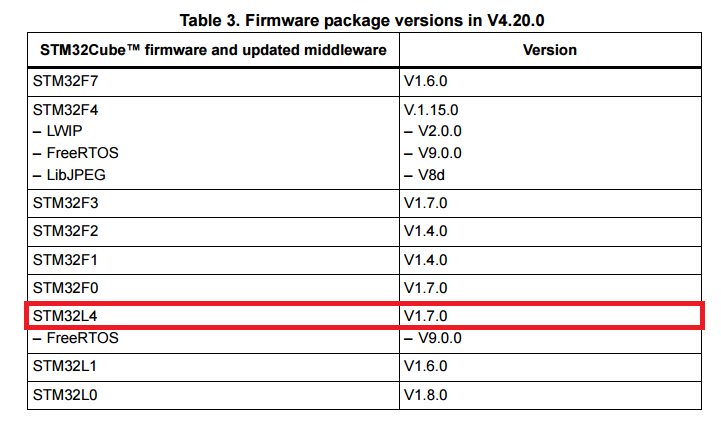

Hi
Block.Robert
In section 2.3 ''Firmware package versions'', it's indicated that for the STM32L4 devices, firmware package version V1.7.0 is supported.
I think you was referring to table 5 of the release note, which is relevant for theSTM32CubeMX V4.0.
