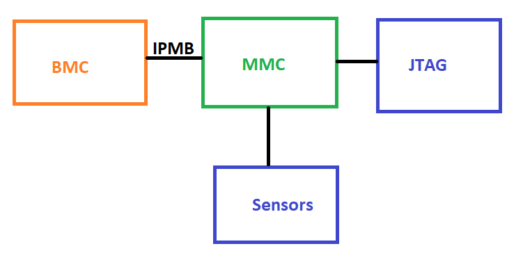

Hi, i am checking IPMB Supported MCU(MMC) Which should able to communicate with BMC Please advice

As you probably know, JTAG was originally developed for testing boards/assemblies, and debugging was added later. In your case you need a JTAG host to access a JTAG slave, which is usually not implemented in microcontrollers.
To answer your questions: The JTAG port can only be used for debugging and testing the STM32. You could try implementing a JTAG host with bit banging, but it's not an easy task.
Good luck!

Peter BENSCH
Welcome, @MKuma.9​, to the community!
IPMB is based on I2C, so basically all STM32 are able to communicate with a BMC.

MKuma.9
Hello Peter,
Thank You,
Is there any example software is available for same ?

If you want to communicate with a BMC via I2C, you should know its protocol so that you can write the software for the communication yourself.

MKuma.9
Can you suggest Any MCU With JTAG.

Almost all STM32 offer a JTAG interface if the number of pins allows.

MKuma.9
With supported JTAG Is it possible access external SoC JTAG ? Or its only for MCU Debugging purpose ?
My application is used to access SoC JTAG from BMC Through MMC By using IPMB-I2C.
Good luck!
