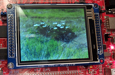

    Yes I can see flower but the color is not right,
    Yes I have define :
    #define Blue 0x001F
    #define Red 0xF800
    #define Green 0x07E0
    I attached the schematic, please check it out, thanks

    // RRRRRRRRGGGGGGGGBBBBBBBB 8:8:8
    // RRRRRGGGGGGBBBBB 5:6:5
    pal = ((pal & 0xF80000) >> 8) | ((pal & 0x00FC00) >> 5) | ((pal & 0x0000F8) >> 3);

    Thanks for the info,
    May I know how can you get those values ?
    antonius
    antoniusAuthor
    April 18, 2014
    Posted on April 18, 2014 at 15:26
    I tested and it gave me the same result, only the color was changing to blueish...
    do I miss something here ?
    I'm attempting to translate the colour space formats.
    Tesla DeLorean
    Guru
    April 18, 2014
    Posted on April 18, 2014 at 23:21
    From my SSD1298 panel

    I'm using SSD1289, is it the same with SSD1298 ?
    Here's the complete function I used

     My LCD initialization code, is it the same with SSD1298 ? may I see it please ? thanks

    antonius
    antoniusAuthor
    April 19, 2014
    Posted on April 19, 2014 at 03:28
    Thanks for the init code,
    Could it be because of init code ? It's a bit strange for me, it's working in your side but not in me ?? We are doing the same code and the same STM32
