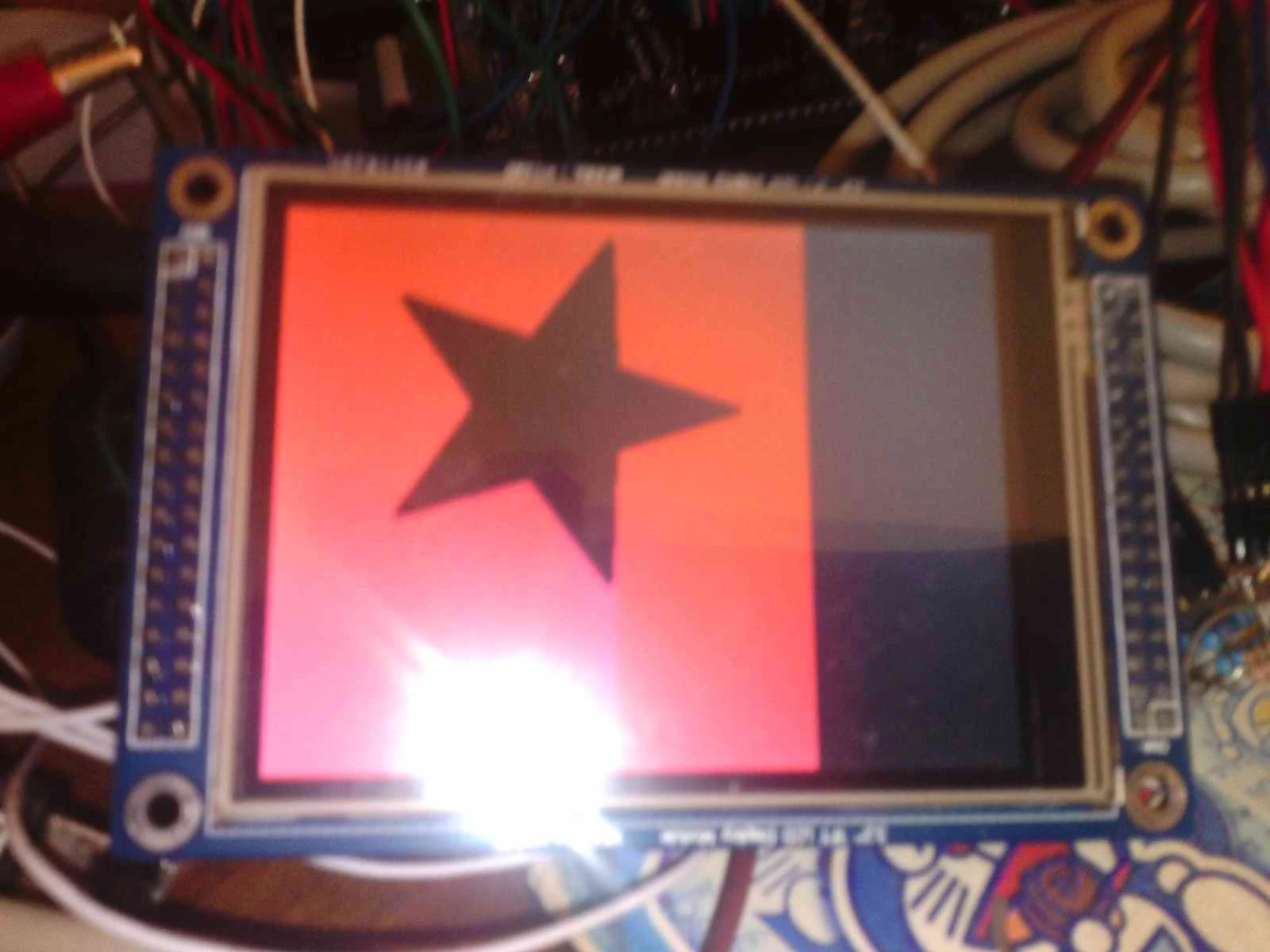

Guys,
Does anyone of you have experience on decoding bmp ?
I want to display bmp file to my LCD...
Any clues ?
thanks

    antonius
    antoniusAuthor
    April 18, 2014
    Posted on April 18, 2014 at 03:59
    Thanks a lot, it works for the star, but why isn't it finished to the end of the screen ?0690X00000602tRQAQ.jpg

    I haven't tried the second code, is it possible if I have 640x480 and resize directly to 320x240 without a code ( automatically resize )? thanks

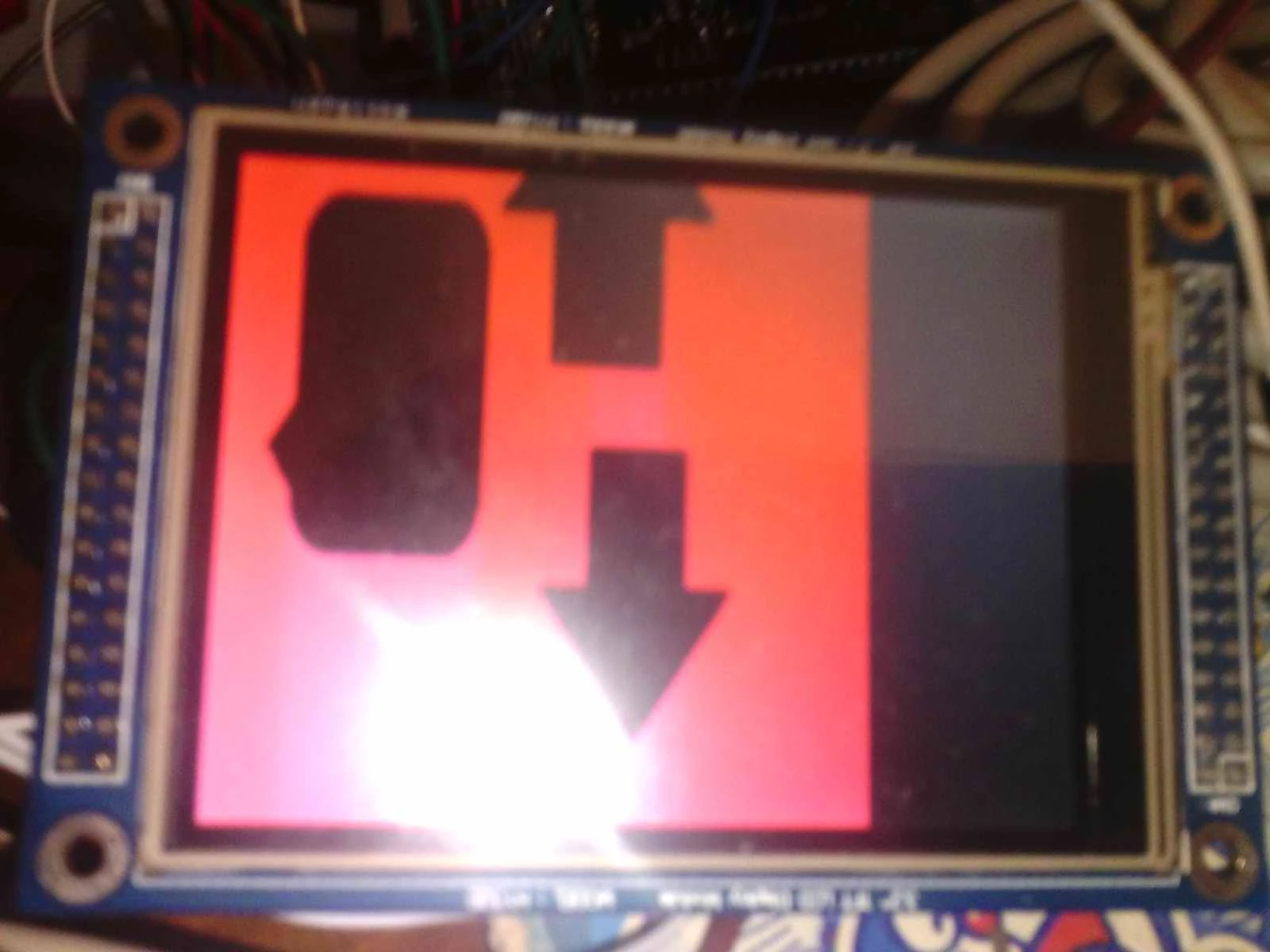

    I tested with different picture, it seems that the x/y is reversed ?
    originally :
    on lcd :
    antonius
    antoniusAuthor
    April 18, 2014
    Posted on April 18, 2014 at 04:20
    fixed :
    for
    (i=0; i<8; i++)
    // Process bits in byte, MSB first
    if
    (b & 0x80)
    // Pixel On?
    LCD_SetPoint(y, x+i, 0xF0F0);
    // Colour
    else
    LCD_SetPoint(y, x+i, 0x0000);
    // Black
    b <<= 1;
    If I want to play with color, what should I change ? for example 256 color of BMP ?
