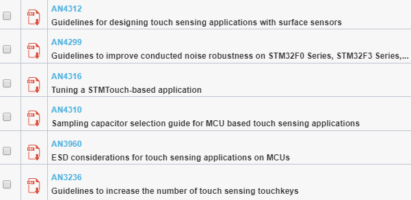

Therefore you should read thoroughly the following application notes (in addition to relevant chapters in datasheet and reference manual):
It is extremely challenging to implement touch sensing functionality on MCUs without touch sensing controller peripheral (full software solution) and achieve good performance and reliability.
