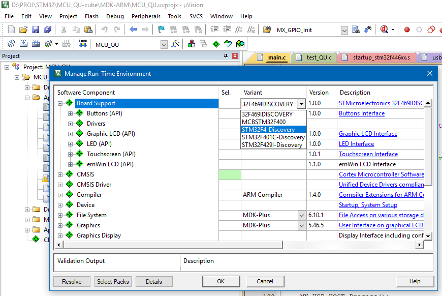

@OP Since you have a ST eval board and Keil, the Keil's DFP should have something that they call "Board support" for that board:
This is all they have to offer. Basically they take this from demo software provided by ST,
but present in nice form with components and checkboxes.
If you have the original ST demo software, you can use that with Keil or any other IDE.
Indeed all this is confusing and takes time and effort to understand.
Good luck.
-- pa

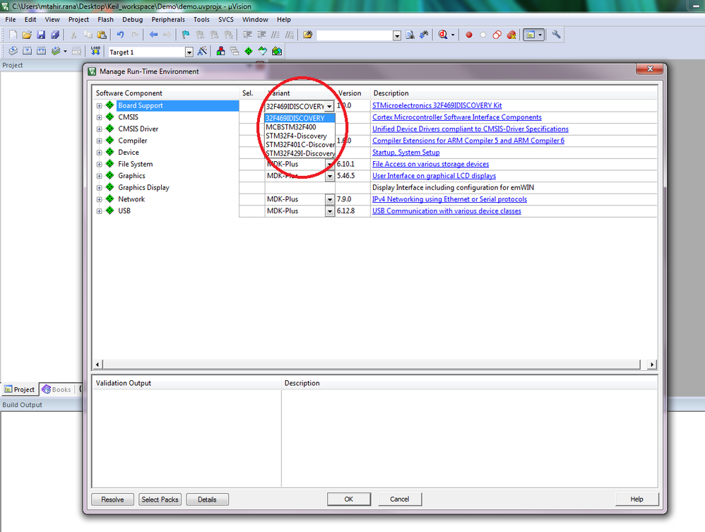

Here is the photo, while I was staring the project. Although I could select the chip in the previous step, but I was not able to locate the board I am working with. That's why I was talking about *.bsp files. May be I am wrong. How will we be adding board support in our project, or we dont need that at all? Please see the picture below:

The STM3240G is an older eval board, the docs state 2011 as initial release.
You might check with the current Keil version if it is still supported (with DFPs). Perhaps at their forum.
MRana
@Community member​
Yes sir, DFPs for the chip are supported, but the board is not supported( so far :) )

As said, I would approach Keil - either via their forum, or per support mail.
But with the DFP for the MCU and ST's example code for the board (the SPL-based one's), you could start without.
Checked last week, the firmware package is still available on ST's site.
Try loading the legacy packs, this is a very old board.
Pretty sure there were examples in the uV4 trees, but likely deprecated in uV5 due to Keil's desire not to have to carry support for thousands of older boards from the last several decades.
Have CubeMX build you a template, or use the CubeF4 code trees.
STM32Cube_FW_F4_V1.21.0\Projects\STM324xG_EVAL\Demonstrations\STemWin
STM32Cube_FW_F4_V1.21.0\Drivers\BSP\STM324x9I_EVAL
