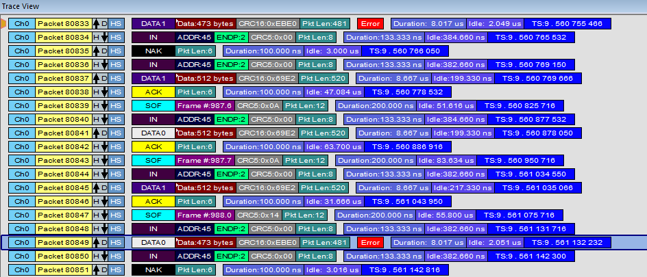

Hello ,
I try to obtain the maximum Transfer-Speed for the STM32 in Device-Mode. I Try to Transfer 15MiB from Device to Host over libusb as fast as possibile.
Every time a ''DataInComplete'' occures, I start another 512-Byte ''DCD_EP_Tx()''-Transfer of generated Data.
My Problem is, that my logic-Analyzer detect every 3 Transfers a Error, probaly because the Data is not complete prebuffered.
What could be the Problem  / What could I try ?

In your trace, two problems are seen,
1) transaction error 2) NAK appears too often
Maybe, it's a problem of endpoint FIFO allocation?
Recommended FIFO allocation is,
usb_conf.h
line:119
/****************** USB OTG HS CONFIGURATION **********************************/
#ifdef USB_OTG_HS_CORE
#define RX_FIFO_HS_SIZE 384 // (in DWORD = 1536 bytes)
#define TX0_FIFO_HS_SIZE 32 // (in DWORD = 128 bytes)
#define TX1_FIFO_HS_SIZE 16 // (in DWORD = 64 bytes)
#define TX2_FIFO_HS_SIZE 512 // (in DWORD = 2048 bytes)
#define TX3_FIFO_HS_SIZE 0
#define TX4_FIFO_HS_SIZE 0
#define TX5_FIFO_HS_SIZE 0
// total 934, 90 DWORD is reserved
2) NAKs While the device is NAKing, transfer speed drops.
You may pass transfer size greater than 512 (one packet) to DCD_EP_Tx(). For example, 4K bytes or more, as much as your data RAM size allows. In this way, you can reduce the NAK ''gap'' between the transactions.

Thanks,
the Problem is solved. When I use the ''DCD_EP_Tx()'' Function for a larger Block (3*1024) no Errors occur on the Bus.
