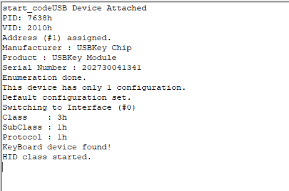

I'm trying to use the stack usb hid to talk with a barcode scanner. When I connect the scanner it is classified as a keyboard, but does not generate the interrupt events. Does anybody know why?

I am using the latest Cubemx version!
It works normally with a normal keyboard, but when used with Barcode, the Usb only Start, not ready
You've got all the equipment in front of you, instrument the code to understand the interaction and perhaps augment that with a USB analyzer if you have one. Perhaps use a software based monitor on a PC, and compare.

The HID host goes to "ready" state after completing few class-defined requests to the device.
Looks like some request fails or the device does not respond.
Debug to understand where it's stuck and how to recover, and use a USB sniffer.
