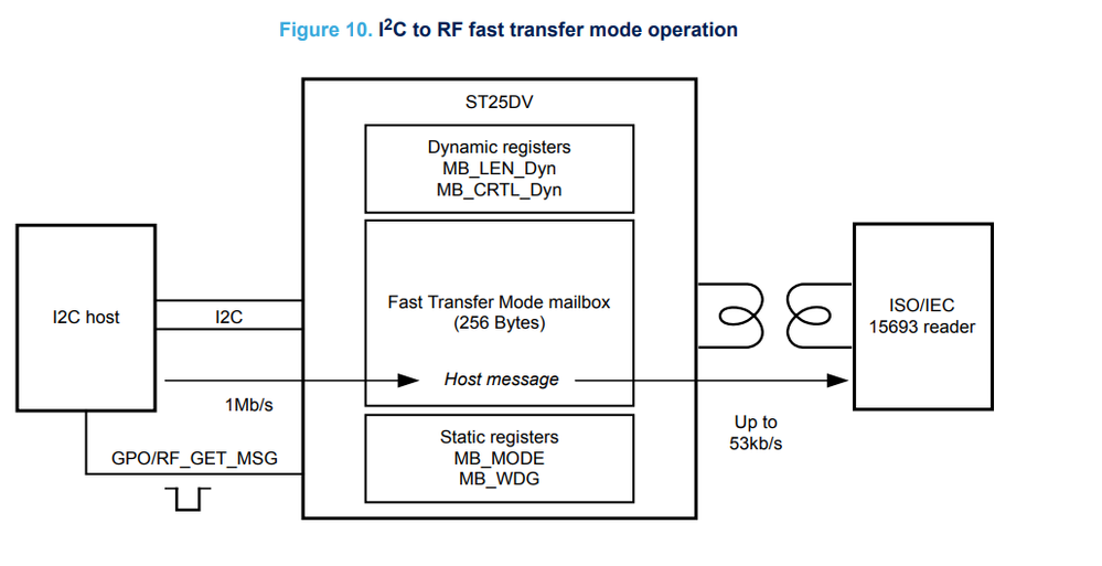

How do I use the i2c example in X-Cub-NFC7 for I2C to RF fast transfer mode, and the MB_CRTL_Dyn register cannot be found in the STM32 CUBE IDE
Brian TIDAL
see en.x-cube-nfc7\Projects\NUCLEO-L476RG\Examples\Mailbox example and related documentation (UM2961 Getting started with the X-CUBE-NFC7 dynamic NFC/RFID tag IC software expansion for STM32Cube)
