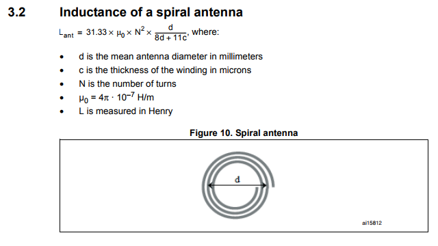

There is a Spiral antenna in the X-NUCLEO-NFC04A1. The link is https://www.st.com/content/st_com/en/products/ecosystems/stm32-open-development-environment/stm32-nucleo-expansion-boards/stm32-ode-connect-hw/x-nucleo-nfc04a1.html
By the document AN2972(How to design an antenna for dynamic NFC tags),In section 3.2 Inductance of a spiral antenna
,there is a calculation formula about a spiral antenna.As follow,
those parameters are:
d = 40mm
N = 8
c = 35um
The result of inductance is   1.7870e-05H.
It is not 4.5uH,Why? because capacitance of st25dv04 is 28.5 pf.
For the ST25dv series,what is the best inductance of antenna? 4.5uH or not?

Henry Crane
​Hello Liu,
 you are right, there is an error in the document and a misleading information in the description:
the right formula is:
L=31.33.µ0. N².a²/(8a+11c) where:
  • a is the mean radius of the spiral a=(ri+ro)/2 where ri is the inner radius and ro is the outer radius of the coil
  •  and c = ro-ri, representing the width of the space occupied by the turns or the summ of turns width and turns spacing . In some literature dealing with stacked windings, it is called the thickness of wires, so sorry for the confusion)
with new formula and a=22mm and c=10mm, it comes L= 4.26µH which is more in line with what is expected.
Please keep in mind that this formula only estimates the self inductance of the coil and not the stray capacitance. Because of the self resonnance frequency caused by the presence of this stray capacitor (few pF generally), the actual  imaginary part of coil impedance is higher than 4.26µH*2*pi*13.56MHz. Finally coil impedance imaginary part is close to 4.7µH which is the chip impedance complex (28.5pF) close to 13.56MHz.
Don't hesitate to contact us for more information,
best regards,
HC.

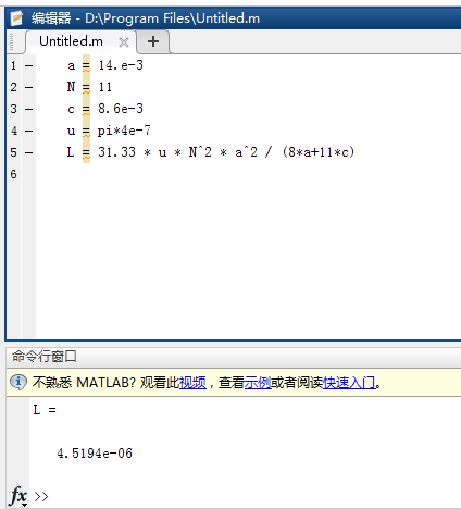

sliu.5
0690X000006DC4HQAW.png thank you again;According to your formula above,I designer a single layer antenna in PCB, Please help me check what is wrong?
a = 14mm; N = 11; c = 8.6mm; u0; ri = 9.7mm; ro = 18.3mm.
Conductor: width = 0.6mm; spacing = 0.2mm; thickness = 35um.:*
BR
KIU​
0690X000006DC4vQAG.pngthank you again;According to your formula above,I designer a single layer antenna in PCB, Please help me check what is wrong?
BR
KIU

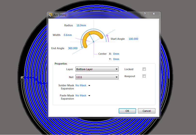

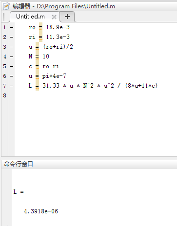

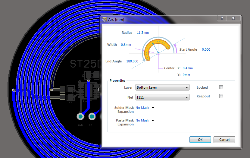

Hi HC,
Thank you for your professional reply.!
Today I modify antenna parameter. As follow Figs, It shows how to test ro and ri value. Is it right?
By this way, ro = 18.9 mm, ri = 11.3 mm, N =10, ==> L = 4.4uH.As follow
By those spiral parameter, the PCB file is attached. Pls help me check again.
Thank you very much!
BR,
Liu
Henry Crane
​Hello Liu,
Antenna is OK for me.
