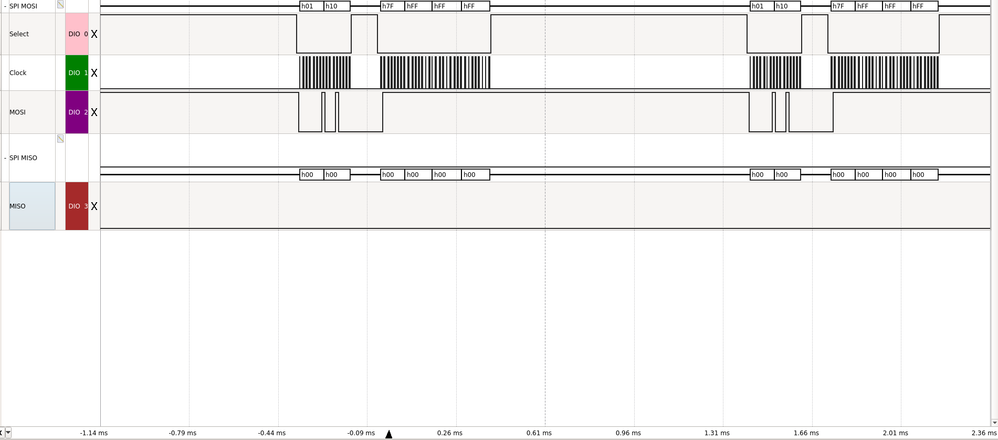

Below is my Arduino code (probably not that helpful) and a screenshot of the commands being sent using a logic analyzer:

LOGIC:

Thanks for the answer.
I am still not receiving anything over MISO. Below is the logic waveform while the 10k pull-down is connected from MISO to GND:0693W000008xruCQAQ.pngWithout the pull-down I am seeing random data on the MISO line:
Could this be some kind of GND issue? What's the best way to test all my ground connections? Again, I am setting up a minimal test like on Figures 2 & 3 of the datasheet.
Thanks for your help.

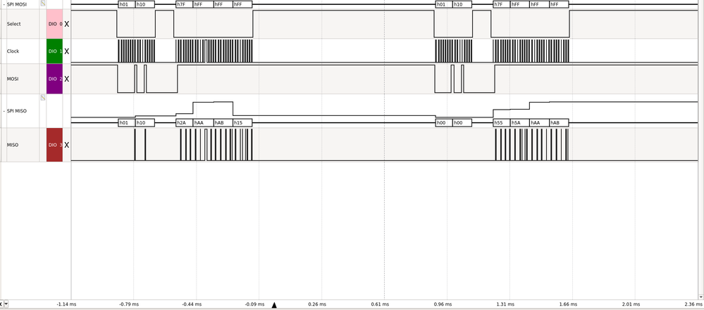

reading random data when MISO is floating and without pull resistor is expected. However the device should respond to 7Fh with one byte. Random data is actually a good indication that nothing else is driving MISO pin. Not sure why you read two more bytes, but not important for the problem at hand.
IMO the device should respond if correctly supplied. Please check VDD_IO, VDD and VSP_D voltages. Please make also sure about proper external components especially on VSP_D.
Maybe verifying your setup by using X-NUCLEO-NFC05A1 as reference could also help.
Regards, Ulysses

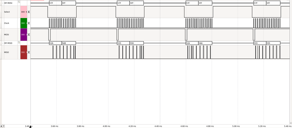

I have stopped using the pull-down resistor. See the below waveform screenshot to see the result. Still seeing random data.
0693W000008y6AiQAI.pngAny other ideas about the best course of action?

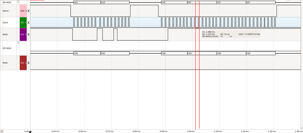

no educated guesses anymore. We had some doubts about clock high pulse length which is not clearly visible in your screenshots. But with SW based banging of signals it should be ok. Do some of:
  • Double check connections on your board (also chip orientation)
  • Measure supply currents
  • Disconnect MCU, connect to X-NUCLEO-NFC05A1 and see if it works there
  • Unpower, disconnect MCU, use multimeter to measure protection diodes and compare against X-NUCLEO-NFC05A1 (red on GND, black on signal)
Regards, Ulysses
