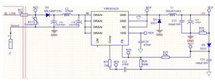

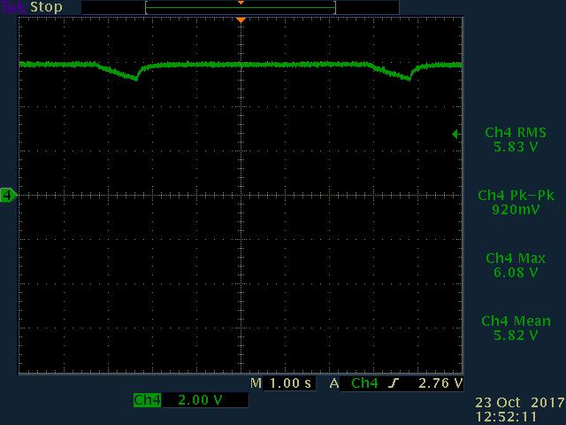

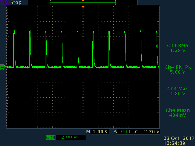

The output Voltage expected is 6V and output is constant for 110VAC input. But the output is turning ON/OFF for 220V input. Please let me know to resolve this issue.
