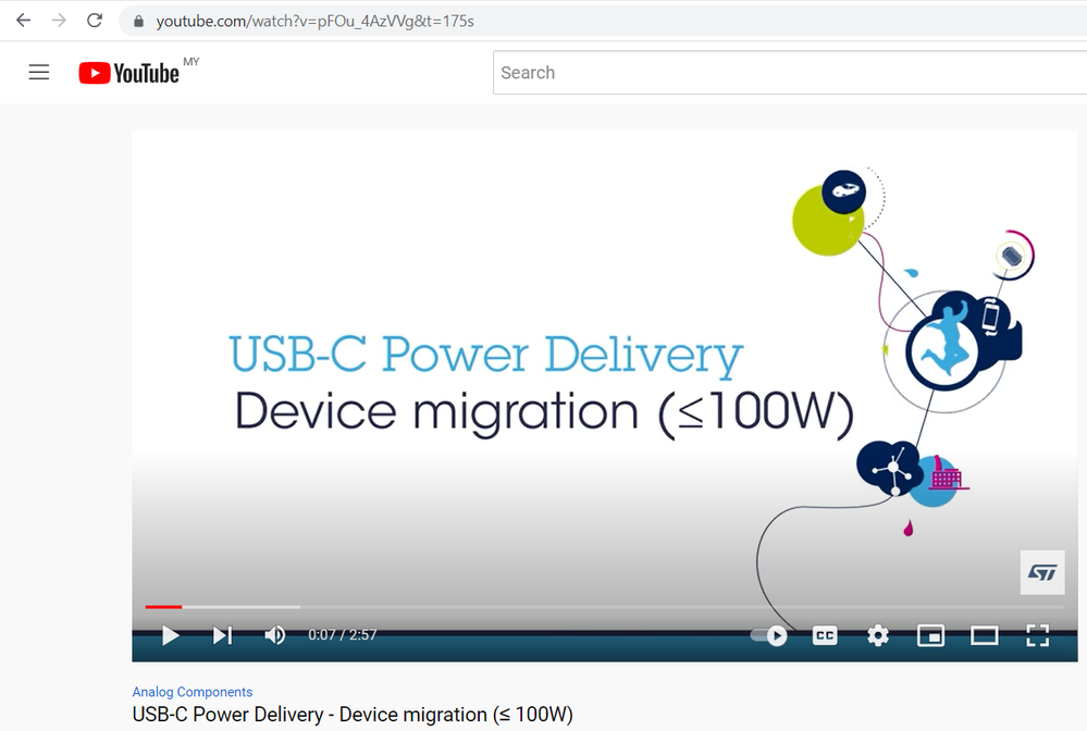

from the video
https://www.youtube.com/watch?v=pFOu_4AzVVg&t=175s
what i see is that, the Eval-SCS001v1 has been pre configured with 3PDO (from lowest to highest)
PDO1:5V/1.5A
PDO2:15V/1.5A
PDO3:20V/1.0A
it shown when it connect to a 5V devices, it can automatically select the PDO1, then when it connect to a 15V devices, it will auto select PDO2. is my assumption correct?

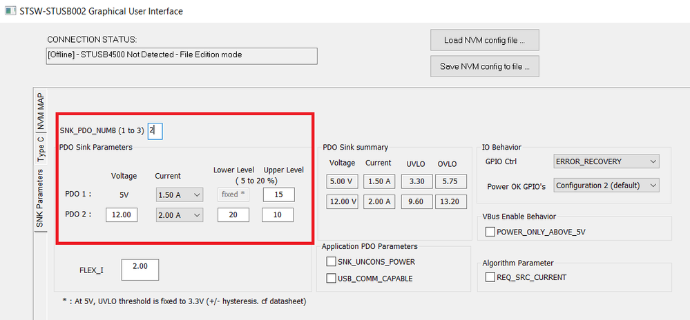

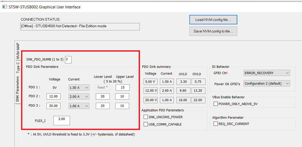

if let say i want to power my uno with 12V.
which 1 should i configured? or both also can,
1st option ( 3PDO )
2nd option (2 PDO)

hi Peter,
yup, agreed. thank you so much on the clarification.
