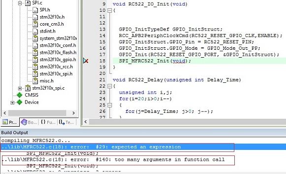

hi every body
i declared a void function
[CODE]
void SPI_MFRC522_Init(void)
[/CODE]
& used it in a main program
[CODE]
void RC522_IO_Init(void)
GPIO_InitTypeDef GPIO_InitStruct;
RCC_APB2PeriphClockCmd(RC522_RESET_GPIO_CLK,ENABLE);
GPIO_InitStruct.GPIO_Pin = RC522_RESET_PIN;
GPIO_InitStruct.GPIO_Mode = GPIO_Mode_Out_PP;
GPIO_Init(RC522_RESET_GPIO_PORT, &GPIO_InitStruct);
[B][COLOR=''&sharpFF0000''] SPI_MFRC522_Init(void);[/COLOR][/B]
[/CODE]
and keil shows me this 2 error:
&sharp29:expected an expression
&sharp140:too many arguments in function call
#keil #stm32f103

That is a general C language issue.
''void'' is not a valid argument when calling a function. And second ''void'' means (in this context) that a function takes no arguments.
Therefore the compiler correctly complains about ''too much arguments''.

Hi Mahmoud,
You've just to call your function as follows:
SPI_MFRC522_Init();
