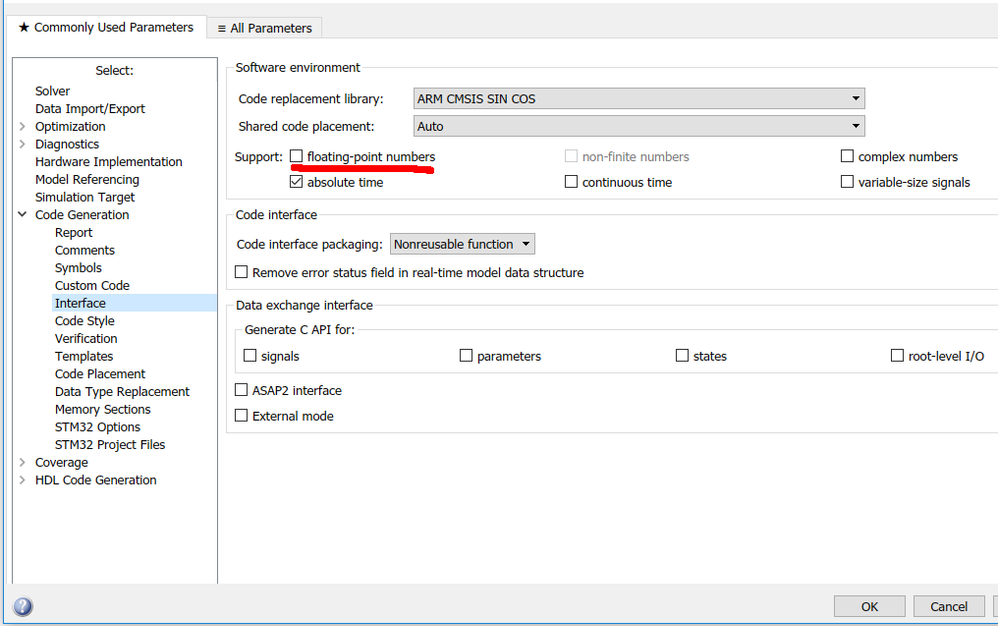

If the check box 'floating point number' is unchecked in 'Model Configuration Parameters':
the following codeto configure the system timer is still generated:
/* USER CODE BEGIN 2 */
 /* Systick configuration and enable SysTickHandler interrupt */
 if (SysTick_Config((uint32_t)(SystemCoreClock * 0.001))) {
 autoReloadTimerLoopVal_S = 1;
 do {
 autoReloadTimerLoopVal_S++;
 } while ((uint32_t)(SystemCoreClock * 0.001)/autoReloadTimerLoopVal_S >
 SysTick_LOAD_RELOAD_Msk);
SysTick_Config((uint32_t)(SystemCoreClock * 0.001)/autoReloadTimerLoopVal_S);
remainAutoReloadTimerLoopVal_S = autoReloadTimerLoopVal_S;//Set nb of loop to do
/* USER CODE END 2 */
where 0.001 is the model execution time step specified in the Simulink model.

Posted on March 05, 2018 at 11:06
Hi, Dima
I have implemented a fix I will send you as soon as possible.
