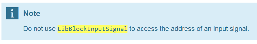

I am trying to send a uint8 through the "Input Data" port on the I2C_Write block. According to the I2C polling example the block expects a uint8. However, when I build the C code and look at it in Keil I get an error in the "User's Data declarations for I2C_Write" saying
"Error: Cannot take the address of an rvalue of type 'uint8_T' (aka 'unsigned char')
I have provided screen shots of my project

Looks like things are a bit broken. My guess would be that the address isn't being handled properly. Looking at the tlc file for the block which should be in the install directory I see the following.
STM32\blks\mex\tlc_c\I2C_Write.tlc on line 230
            %else
                %if !%<LibIsEmpty(Target_Register)>
                    %assign Data_str = LibBlockInputSignal(0, "", "", 0)
                    uint8_t* %<block_name>_aTxBuffer  = &%<Data_str>;
                %endif
            %endif
I think this is not suppose to be done this way:
https://www.mathworks.com/help/releases/R2018b/rtw/tlc/input-signal-functions.html?searchHighlight=libblockinputsignal&s_tid=doc_srchtitle
I would look into the function LibBlockInputSignaladdr instead.

Wow, thanks Taylor! Changing removing the LibBLockInputSignal and adding the LibBlockInputSignaladdr function in STM32\blks\mex\tlc_c\I2C_Write.tlc worked!
You should get a job at ST!
