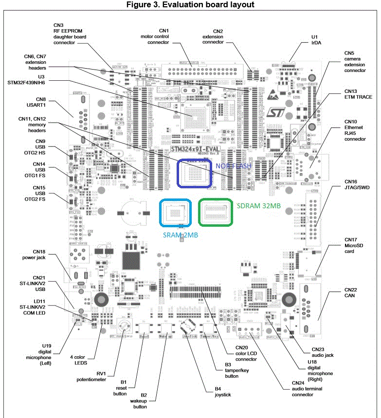

I am working on a project on the stm32 eval2 board that requires about 600 kB of RAM.  Do I need to add external memory to the FMC bus? Or is all the memory I need already provided with the board.  I do not understand this very well, I don�t think, so any help would be appreciated. Also I am using keil v5 and c++.

I have looked at the schematic and the memory map, but I am having a hard time figuring out where to initialize the RAM.
pncardella
Posted on July 31, 2014 at 13:57
From what I am understanding from the memory map (attached), I need to add some external RAM to meet my needs because all of the memory set aside for RAM is being used.

Good grief, this is getting to be unnecessarily complicated.
The board should have 32 MB of SDRAM memory situated at 0xC0000000 in the memory map. This memory would need to be initialized (external bus, pins, control, chip) by code in system_stm32f4xx.c -> SystemInit() -> SystemInit_ExtMemCtl()
Look at some FMC/FSMC example for your board
STM32F4xx_DSP_StdPeriph_Lib_V1.3.0\Project\STM32F4xx_StdPeriph_Examples\FMC\FMC_SDRAM
STM32F4xx_DSP_StdPeriph_Lib_V1.3.0\Project\STM32F4xx_StdPeriph_Examples\FMC\FMC_SRAM
STM32F4xx_DSP_StdPeriph_Lib_V1.3.0\Project\STM32F4xx_StdPeriph_Examples\FMC\FMC_NOR
