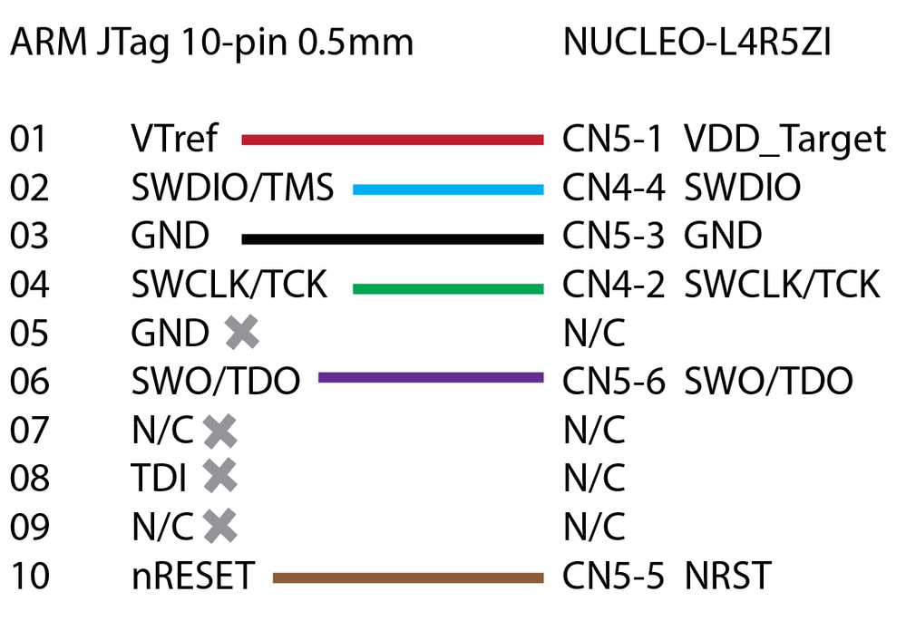

I'm following this guide (https://mcuoneclipse.com/2015/08/22/debugging-stm32f103rb-nucleo-board-with-with-segger-j-link/)
The board I am using is NUCLEO-L4R5ZI. I've connected the following pins to the 10-pin ARM connector:
I've also tied the VDD_Target/VTref pin to 3.3V.

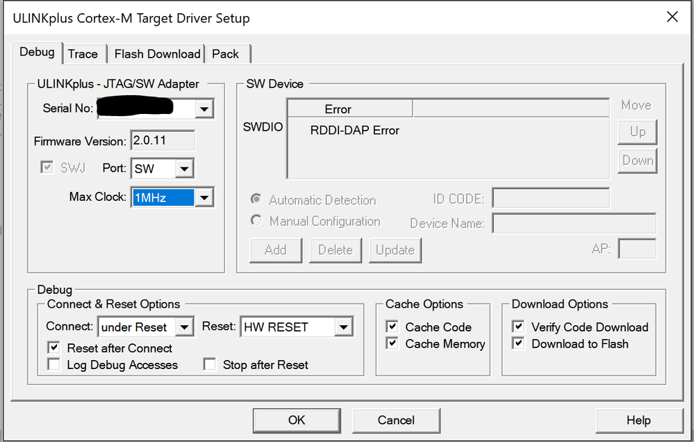

When I launch Keil uVision5, I go to Project options and select the debugger. I am getting a "RDDI-DAP Error".

0690X000006C4DzQAK.png@Community member​ No, I think it is correct. Anyhow, I also swapped them and no luck. Here is a cleaner pinout and connections.
Is there a problem with CMSIS-DAP compatibility? I am curious why this won't work :(

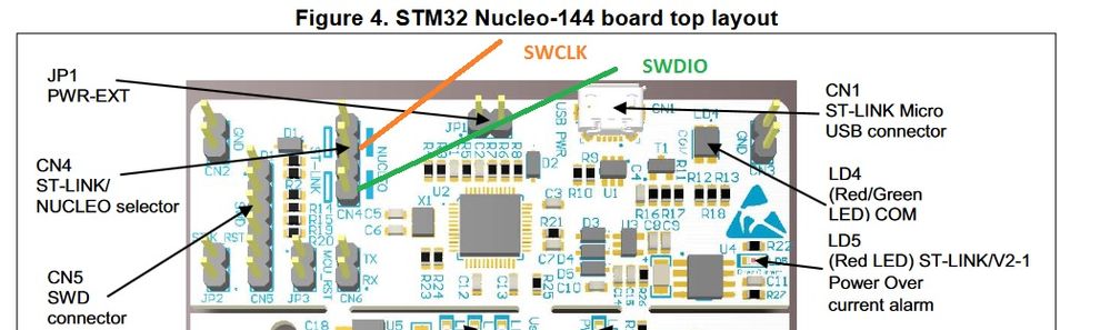

Don't use that connection for SWDIO and SWCLK, go in via the target side of the jumper pins.​

Specifically CN4, the lower pin on each pair connects to Target SWCLK (NORTH), SWDIO (SOUTH)
Spectramax
I just connected the SWDIO and SWCLK to the target side through CN4 with the rest of the stuff still in the CN5 connector.

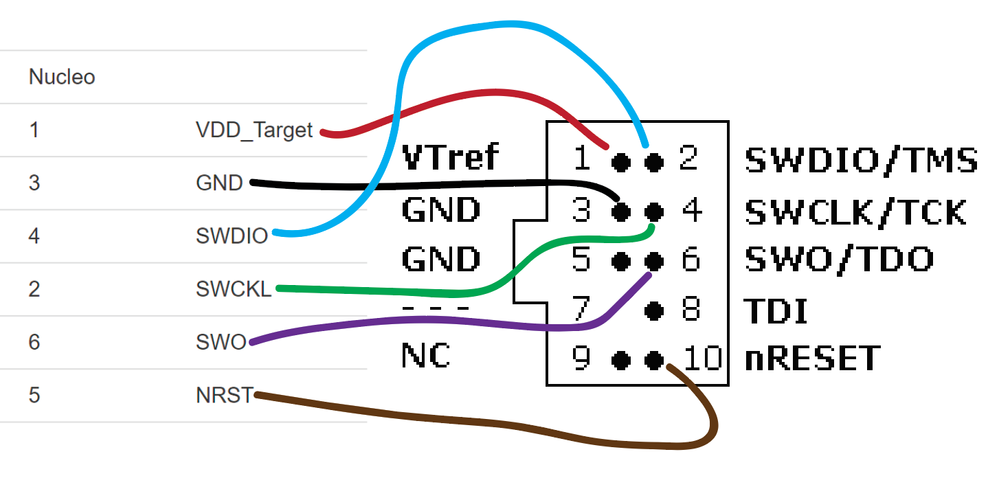

You seem to have 2 and 4 switched in your picture vs your chart 2=SWCLK, 4=SWDIO, would me easier if you'd draw them in numeric/pin order
Spectramax

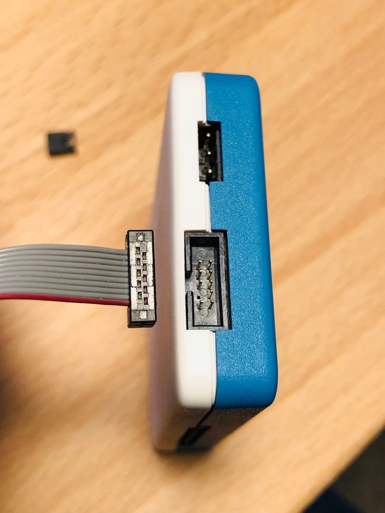

0690X000006C4E9QAK.jpgLooks like I might have found the problem. The 10-pin fanout cable's pin 1 (Red wire) is not on the same side as the 10-pin socket on the ARM UlinkPlus debugger.
Here is a picture of how the cable connects to the socket.
Spectramax
Yep, that was indeed the problem. I am now able to connect.
Anyone who is reading this thread in the future, please use the diagram above to connect to your STM32 Nucleo board and Ulink/Ulink2 or UlinkPlus debuggers from ARM Keil.
