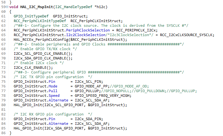

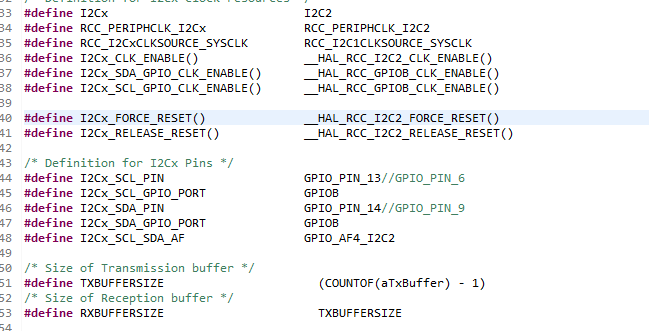

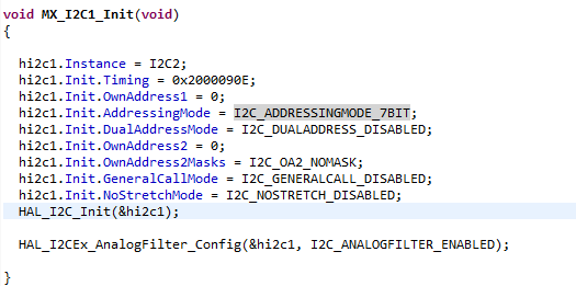

0693W00000LyKkwQAF.png0693W00000LyKkhQAF.png0693W00000LyKkXQAV.pngwe used internal I2C HAL function and getting Ack failure while communication with EEPROM.

is correct configuration?
