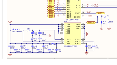

I recommend to consult the reference manual (RM0090), sections 5.1.1 and 13.2 in this regard.
Some larger packages have a separate Vref+ input pin, others not. In the latter case, VDDA is used.
The F407 discovery board does have a variant with separate pin, but connects VDDA to it.
Here the relevant excerpt from the ST F407 discovery board :
As said, check with the schematics of your board.
The Vref voltage is connected to an internal ADC channel (by a voltage divider) for measurement, as a side note.
To state it more clearly, Vref+ represents the maximal ADC conversion result, i.e. 0x0FFF for 12 bit.
If this Vref fluctuates, all other ADC conversion results fluctuate proportionally.

As I understand the datasheet and the reference manual, the normal ADC channels of the F407 always use Vref+ as reference voltage.
As mentioned, check the schematics of your board, and measure Vref+ directly at the MCU pin, in both supply scenarios (ST-Link and external 5V).
A good multimeter should be sufficient.

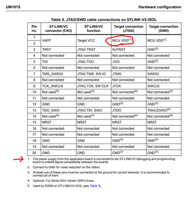

Re-reading a former post :
> What I meant to say was that STLINK V2 has A 5V output provision, this output is connected to the 5V header pin of the M4 demo board.
I don't think so. At least if you mean the stand-alone ST-Link device:
The user manual mentions several times that this pin is only used the "ensure signal level compatibility", but nowhere does it say it might be used to supply the target.
Newer onboard and stand-alone ST-Link variants explicitely say so if possible, and state additional constraints.
SohamC
STLINK purchase link:   In this there is a provision of 5V , which I used in the circuitry and measured on a DSO. It gave a stable 4.8-5V.
You might be correct , I could have used it wrong until now, but it has worked.
Further I did some changes in the firmware on how to use the VREFINT in increasing the accuracy according to this video , you can see on minute 9:38.
This resulted in change of reading. The vref obtained using STLINK V2 was around 3.199,
And the Vref measured using a linear power supply was 3.26V-3.27V
This still did not solve the issue , the measured adr8495 output was still around 80-90mV
Which does not mean this pins is meant to supply a target, and deliver enough current.
You would have to check with the schematics, which are probably not publicly available.
But this remark in the user manual is more than a hint.
