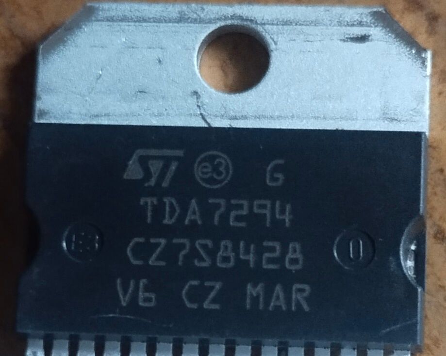

What does the letter MAR printed on the STmicroelectronics TDA7294 IC mean?
See attached image file
Thanks
TDA7294
CZ7S8428
V6 CZ MAR

Welcome @SREYAS, to the community!
Well, this part of the marking is internal only. But it relates to a country...

CZ/MAR
Assembly and Test out of ST Bouskoura, Morocco Plant, would be my best interpretation
The V6 indicates the diffusion site is the AMK 6 - 6" wafer out of ST Ang Mo Kio (AMK) TechnoPark in Singapore
