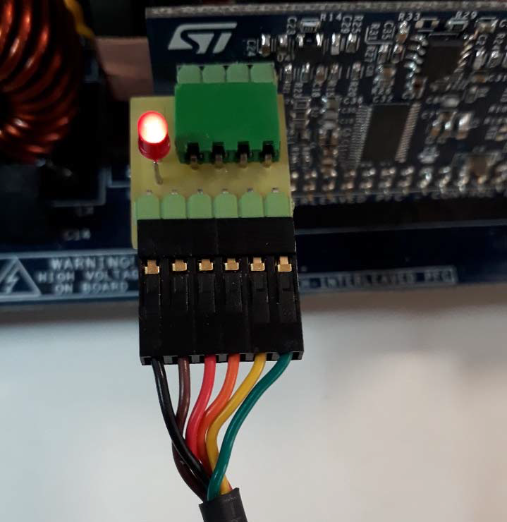

  1. Insert an FTDI cable into the USB port of the PC.

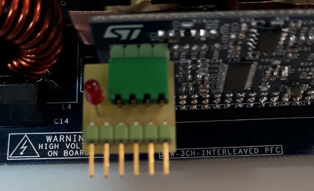

  2. Insert the adapter board into the programming ports PTX and PRX of the STNRGPF010690X000006090xQAA.png
  3. Connect the adapter board with the FTDI cable
         As soon as the adapter will be connected with the cable FTDI, the LED on the top will be lit.

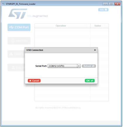

    1. USB COM port selection

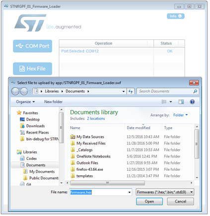

    2. *.hex file selection

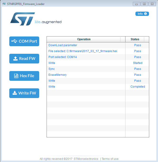

    3. firmware download
