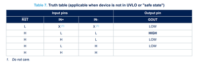

STGAP3Sxx datasheet error - DS14758 Rev 2
SteveC1
I assume that in the truth table in page 14 of DS14758 Rev 2:
The low & high values in the final column should all be shifted down by one. i.e.
nRSTIN+IN-GOUT
LXXLOW
HLLLOW
HHLHIGH
HLHLOW
HHHLOW
