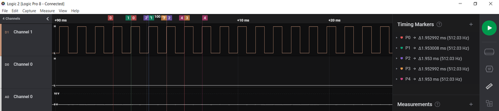

Hi ST team,
I referred the Application notes from the ST's for RTC temperature compensation
Using STM8AL3189 MCU , Which has both positive and negative ppm compensation using CALM and CALP
From the APP notes, ACC(ppm) = crystal deviation + k * (T -T0)^2;
How to find the crystal deviations room temperature. i followed as per app notes
32768 Hz prescalar value , CALOUT is 512Hz
when measured using the logic analyzer i get 512.030Hz
((512/512.030) - 1) * 1000000 = >
0.99994140968302638517274378454387 - 1 * 1000000
-5.8590316973614827256215456125618e-5 * 1000000
-58.5 PPM
it is correct ? any suggestion helps to move forward

Peter BENSCH
Yes, your calculation is correct. But you should also take into account the possible error in the frequency measurement (here your logic analyzer).

First of all, you must be aware that the measured frequency of 512Hz is derived directly from the 32kHz LSE. The Smooth Calibration does not correct the LSE frequency, but masks or adds individual pulses for the RTC within a 32-seconds cycle (precisely a cycle of 2^20 RTC clock pulses), depending on the value of CALM/CALP. An essentially identical procedure is also used by the STM32, which I explained some time ago in a similar thread.
Update rate
Because corrections are only made once per 32-seconds cycle, you should not adjust the values of CALM/CALP more often than once in 32 seconds.
Once again: after changing CALM/CALP you will not be able to measure any change in the output frequency (512Hz) - apart from drift due to e.g. temperature. In order to determine a possible deviation of the RTC, you must permanently compare / measure the 512Hz with a very precise reference and update CALM/CALP in intervals of ≥32s.
