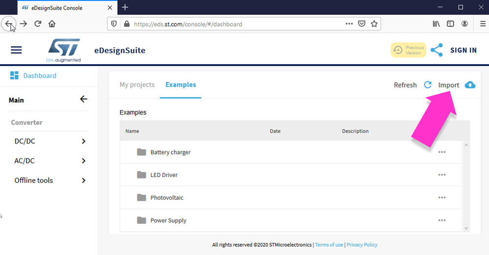

Hi every one I cannot open the file .prj created by edesign suite with designspark? it says unatended file format Thank you

on the left-side menu of the Main window of eDsesignSuite, click on `Dashboard`, it opens the section from where you can open previously saved project or load examples we provide or import `. prj` files => at the top-right corner of the Dashboard section/window you will find the "Import" link-button.
Please, be aware that old exported projects can be imported back only from their originator modules, some of them would require Flash Player Plugin

I am also looking for a way of opening the .prj file export. ST hasn't stated that info anyway?

Is there a solution to open the .prj file from the edesign suite.
M. Palano
