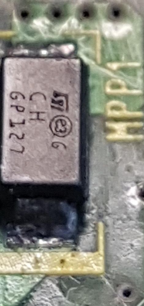

I want to know about the parts in the attached photo.
I want to get a datasheet for the parts shown in the picture,
and I want to know if I can replace it with a company other than ST.

This part does not show up in our system. however if you can provide a partial or full schematic, we can try to help further. I have a gut feeling this is a general purpose diode. As I have a few similar 'GPxxx' diodes at home

Ah, this should be our SMAJ28 TVS
here is the product page link:
http://www.st.com/content/st_com/en/products/protection-devices/eos-10-1000-microsecond-surge-protection/400w-tvs/smaj.html
Grab the datasheet from this page/link and see page 8 - markings correlate. And I was able to further search our database to correlate to this family part, so that's a good thing

Thank you so much.
