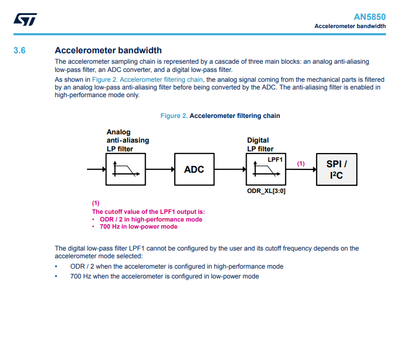

What is the cut-off frequency of the analog anti-aliasing filter in the ISM330IS?

You can find this information on AN5850 at page 17:

This page does not give any information of the cut-off frequency of the anti-aliasing filter. Do you have that information?

You can find the cut off frequency of the LPF1, unfortunately the frequency of the anti alias filter is reserved.
