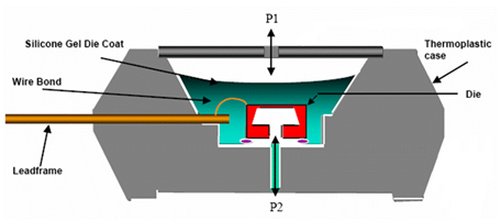

Figure 1 illustrates the physical internal structure of a pressure sensor. To help you understand how pressure sensors and pressure measurement work, it is a cross-section of a standard pressure sensor.
Figure 1: Internal structure of a pressure sensor (cross-section).Figure 1: Internal structure of a pressure sensor (cross-section).
In figure 1, the positions of ports P1 and P2 are indicated. The importance of these ports and their positions for pressure measurement is explained in the following sections.
The die and wire bonds are protected with silicone gel. This gel can be damaged, leaving the die and wire bonds exposed to the media, if the sensor is used with media other than dry, clean air.

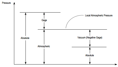

The relationship between absolute pressure, gage pressure, and vacuum is shown in figure 2.
Figure 2: Relationship between absolute pressure, gage pressure, and vacuum.Figure 2: Relationship between absolute pressure, gage pressure, and vacuum.

  • Gage (gauge) pressure is the difference between absolute pressure and local atmospheric pressure. In this configuration, port P2 is exposed to the local atmosphere, and pressure is applied to port P1. Local atmospheric pressure varies depending on ambient temperature, altitude, and weather conditions. By convention, gage pressure is always positive. A negative gage pressure is defined as vacuum, which is the amount by which local atmospheric pressure exceeds absolute pressure. A perfect vacuum is zero absolute pressure.
Figure 4: Gage (gauge) pressure.Figure 4: Gage (gauge) pressure.
