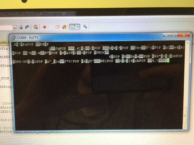

. I have two problems with connection between my modules.
First of all SPSGRF is sending to me very weird strings shown below:0690X00000603qEQAQ.jpg

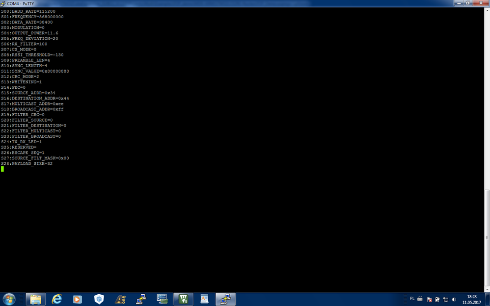

Below I have posted one more images showing the configurations of SP1ML module and code from Keil showing a configurations of SPSGRF module
https://codepaste.net/kxohms
. I checked: this is not problem with Baud Rate but I think it is problem with radio configuration. I also changed S28: PAYLOAD_SIZE to other value, but that didn't change anything.0690X00000606wGQAQ.png
