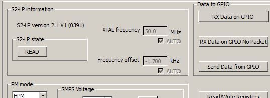

hi
does anybody nows how the auto fequency offset works?
is there a register? it works only with the steval board ?
how does the board calculate the correction?
Thank's
marco
2 REPLIES 2
Winfred LU
The board does not calculate the offset.
S2-LP chip has been calibrated during manufacturing the board, and the offset is stored in the EEPROM on the EVB.
Then GUI reads EEPROM and gets the offset value.
