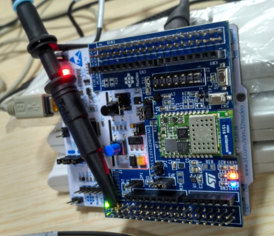

Hello ST community,sorry,maybe I should post my problem here.
Now I am working on the wifi module
X-NUCLEO-IDW01M1
,I found some problem.
Hardware
:NUCLEO-F401RE,X-NUCLEO-IDW01M1
Software
:STM32CubeExpansion_WIFI1_V3.0.1
IDE
: iar arm 7.1
From the example project I found two types one is SPWF01 another is SPWF04, I found the exampleBinary is the SPW
I change the config to SPWF01,but it still not work.
1)en.x-cube-wifi1_firmware (1)\STM32CubeExpansion_WIFI1_V3.0.1\Projects\Multi\Applications\
WiFi_VCOM
From the Tera term I found the print message,but when I input 'AT+S.STS',nothing output.
2)en.x-cube-wifi1_firmware (1)\STM32CubeExpansion_WIFI1_V3.0.1\Projects\Multi\Applications\HTTP_Request
From this example it will always run at the wifi init.
file
wifi_module.c line 294
and can not run out this function.It seems to wait for the state.
I only changed one thing in wifi_conf.h
the old one is #define SPWF04,I change to
#define SPWF01
while(IO_status_flag.WiFi_WIND_State != WiFiHWStarted)
__NOP(); //nothing to do
//always in this function
If I press the SW1 button,only the LED2 and LED4 from on to off then on,the code can not exit the loop.
Is there anyone can tell me what is wrong ? Thank you very much.

Thanks a lot for your reply.
Sorry I got the wrong connection,I monitor the RESET line and PA13 of the F401RE.
Today I test it again
GPIO10 is high at first,after I enter the SSID, password, encryption,then it will become to low 200ms then to high.
GPIO13 is alway low.
GPIO14 is alway low.
from the F401RE schmetic GPIO10->PD2,GPIO13->PA4, GPIO14->not out from CN7 or CN10 from wifi module board.

Thanks a lot for your help.
The board is OK now, the FAE help me update the firmware of the WIFI module.
It work fine now,
