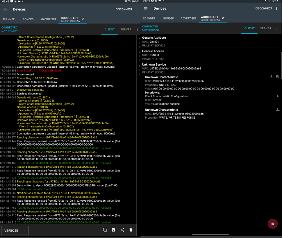

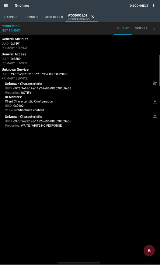

I try to read the data from BlueNRG-M2SP on an android application. For that with my STM32 I send to the UART a "u". On the application, I scan the services and Characteristic and I only find a write Characteristic but no read Characteristic, and I can't find in the documentation (https://www.st.com/resource/en/programming_manual/dm00294449-bluenrg-1-bluenrg-2-ble-stack-v2-x-programming-guidelines-stmicroelectronics.pdf ) how to have a read Characteristic on the custome service.0693W00000KdNpAQAV.png

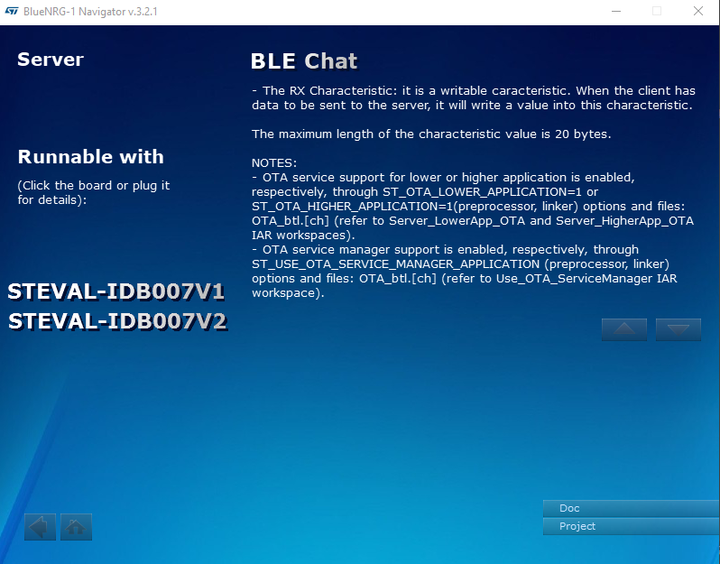

i use the code exemple BLE chat Server that can find on the BlueNRG-1 Navigator
0693W00000KdNolQAF.pngOn the code exemple i find some UUID but that doesn't work when i try to read data from the STM32

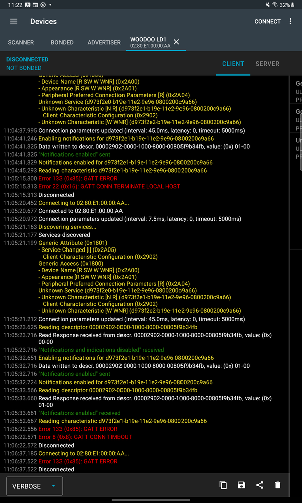

Thanks for your reply @Winfred LU, I changed the feature property to notify and read, and added some code from the sensor demo, but I can't read the data from my STM32, and now when I try to read, it automatically disconnects.0693W00000KdWc5QAF.pngThere the code where i set my service and characteristic:

Winfred LU
Please check for the return code and events on the BlueNRG-M2 side, which will provide more clues.
My guess would be that you set the GATT_NOTIFY_READ_REQ_AND_WAIT_FOR_APPL_RESP, but in the application you did not give permission to the read command.
Try to use GATT_DONT_NOTIFY_EVENTS instead.

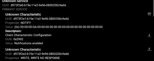

PCong.1
Ok now, the application doesn't disconnect when I read but I'm still not able to read what my STM32 sends, I get a long 0x00.0693W00000Kdgu4QAB.png
I tested with STEVAL-IDB007 which worked properly.
If you would like to read whatever was written previously, it is supposed to write to and read from the same attribute with both read and write permission.

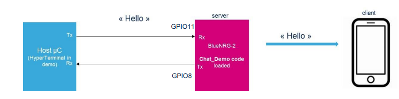

Please clarify your environment, if i understand correctly :
  1. BlueNRG-M2SP is connected to STM32 (host) as a network coprocessor over UART interface
  2. The STM32 + BlueNRG-M2SP acts as a GATT server that will be connected with an Android phone
  3. in the STM32 application, you'd like to modify some attribute thru UART/ACI, that will be read remotely by that connected Android phone
If my understanding is correct, please modify the attribute with aci_gatt_update_char_value_ext() ACI, as suggested in the sample project. In your posted code, SensorUpdate() function.

my environment is simple the next
I managed to get the "u" on the notification (the solution was to add the end character CR+LF).
The problem is that the BLE doesn't want to read an int without an end character and I can't do like a printf because it won't read the variable a and will return 0 and the end character
