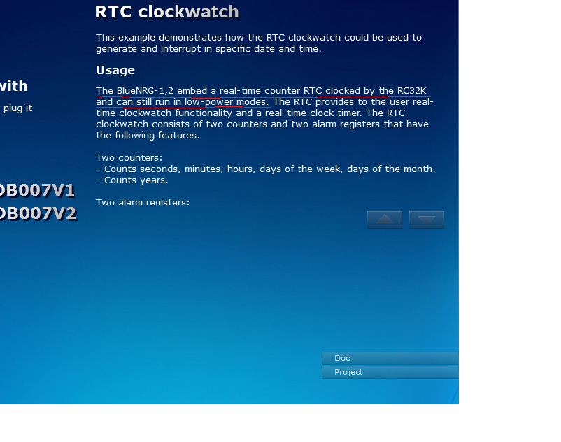

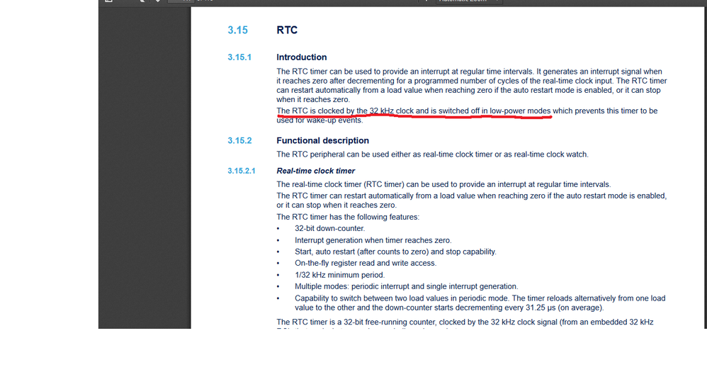

Does in bluenrg2 RTC working in sleep mode?
Andriy Mark
In datasheet said:0690X000006DMiqQAG.png
But in BlueNRG-1 Navigator i found this:
1 REPLY 1
DActi
I have the same question, can someone answer it ?
