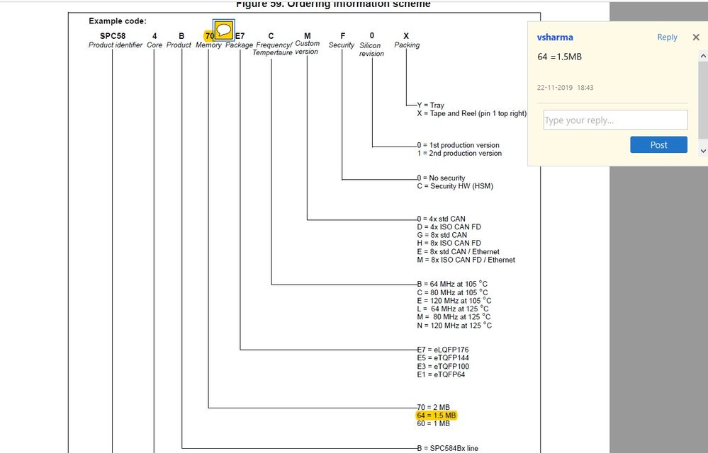

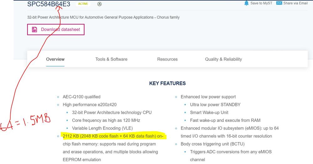

SPC584B64E3CDC0 Flash memory size of this chip
VSHAR.1506
In Datasheet 1.5MB
in STwebsite 2MB

Hello ,
According to the last RM (RM0449 Rev3).
It is 2MB of flash.
Best Regards
Erwan
