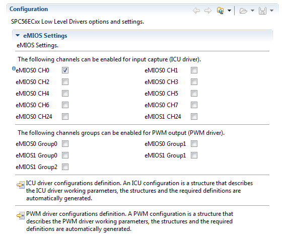

2015-09-03 1:49 AM

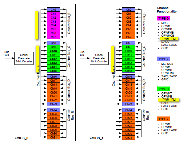

On SPC5Studio V3.6 and SPC564B74. I would like to use ICU eMIOS_0 ch. 9 (PA[9], E0UC[9]) but eMIOS ICU config in HAL layers is only listing ch. 0 to 7 and ch.24. It should lists ch.1 to 7 and 9 to 15 on eMIOS_0 and ch.9 to 15 on eMIOS_1 according to reference manual, right? If you confirm the issue, can you please advise on which files should be modified? Please see screenshots below. Thanks, Aurélien2015-09-03 8:25 AM

and add the matching handler for channel 8 and channel 9

Ok, but I will still have to modify mcuconf.h to declare:
#define SPC5_ICU_USE_EMIOS0_CH9 TRUE and this files is overwritten at each code generation.
