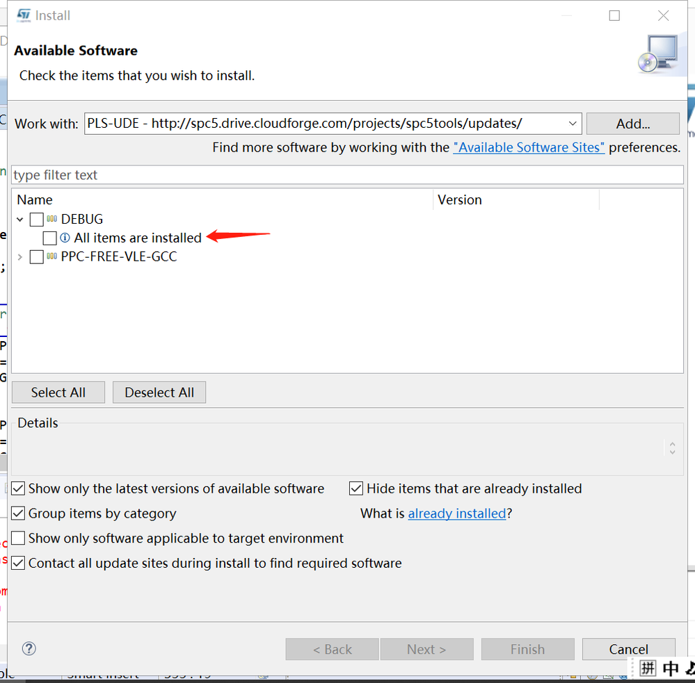

Thank you for your answer. but I can't install PLS UDE Tool according to the steps. Do you know how to solve it?
Best Regards
Ye Fly

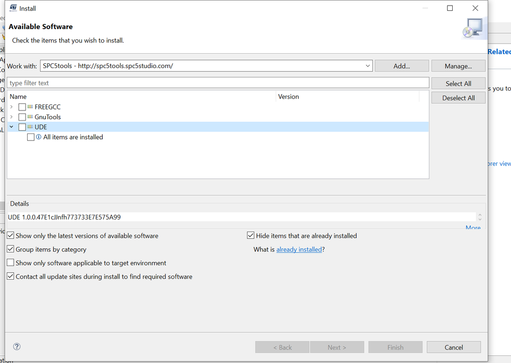

Hello, I had the same issue on my computer. I installed UDE PLS on my host machine, but i can't execute application.

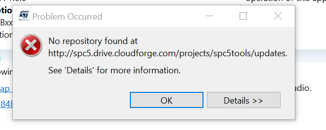

When i tried to install updates , i got this error :
About my environnement
I had:
- SPC5 Studio, version: 6.0 with free gcc license
- UDE starterkit 5.0
- I don't have Administrator rights. is that required?
