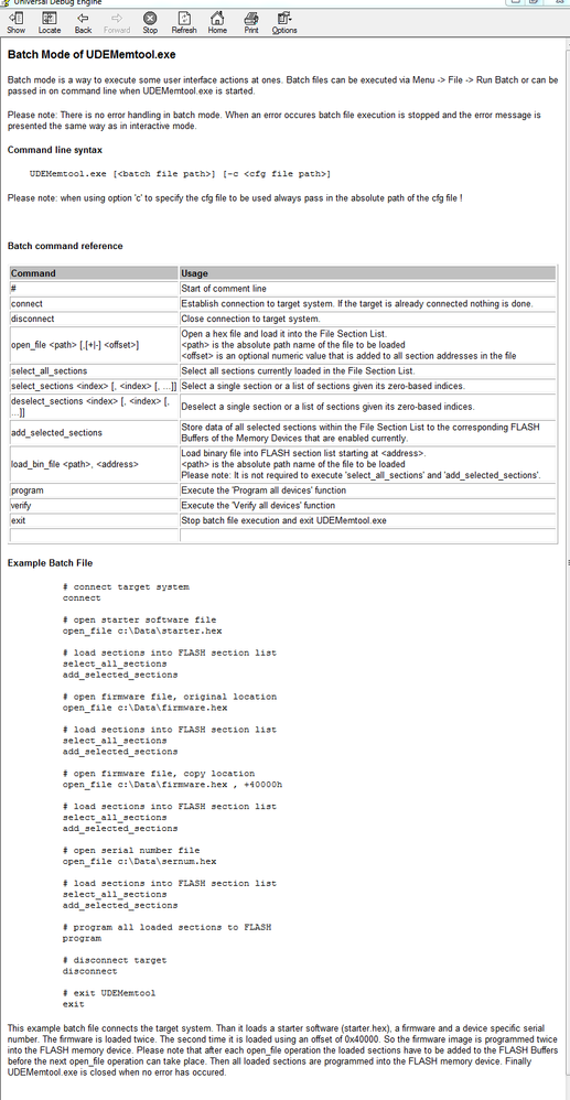

I want automate test procedures. How I can flash spc5x MCUs from command line using SPC5-UDESTK programmer?

Hello Vladimir ,
you can UDEMemtool.exe in Batch mode cf screenshot
We have in our company some automatic tests benchs with Continuous integration.
i will ask to the right person.
