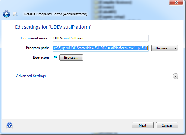

Hi, I have SPC560P-DISP board with FTDI . I have install UDE SDK 5, i can see debuger in Device manager ( windows 10 ) but unable to access "Excecute and Debug your application" Please tell me how to access the debuger.
Pradnya
also saved Hitec license in SPC5STUDIO

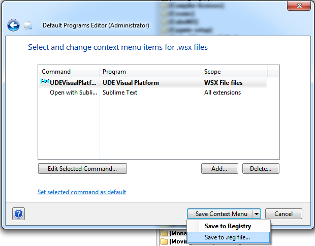

Hello Rimzim ,
it is a PLS issue on Windows 10
you can access it by launching the external tool
or
Use DefaultProgramsEditor Standalone
1)   File Type Settings
2)   Context Menu
3)   WSX Extension to change
4)   Add or Change UDE Visual Platform (cf screenshot 1)
5) Save the context menu and registry file (cf screenshot 2)

Pradnya
Hi Erwan,
Thanks for the reply. Currently I am using UDE by launching external tool.
I don't have .wsx file in my 'default app by file type'.
While developing s/w, for breakpoint debug; SPC5Studio with debuger is essential.
Any help at all would be appreciated.
