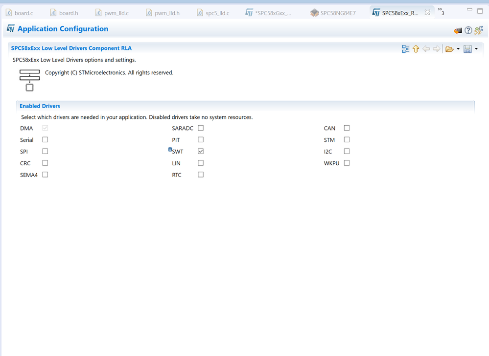

I'm trying to find low level driver for GTM peripher into SPC5 Studio.
I've installed SPC5 studio version 5.8.1 and "SPC58xExx Support" 1.0.0.20200908161213 but I didn't find it.

Hello ,
you can find the drivers :
GTM 1.14.0
  • SPC574Kxx, SPC572Lxx: update default value in CMU IP
GTM Premium 2.0.0
    • New GTM ARU API
    • Redefine Macro in CRANK Emulation
    • Update Crank Emulation
    • Add priv ptr in DTM module
    • Define GTM-Engine Lib. dependencies
in the following update site :
http://download.spc5studio.com (GTM)
http://gtm.spc5studio.com (GTM Premium credentials needed)
Best regards
Erwan
