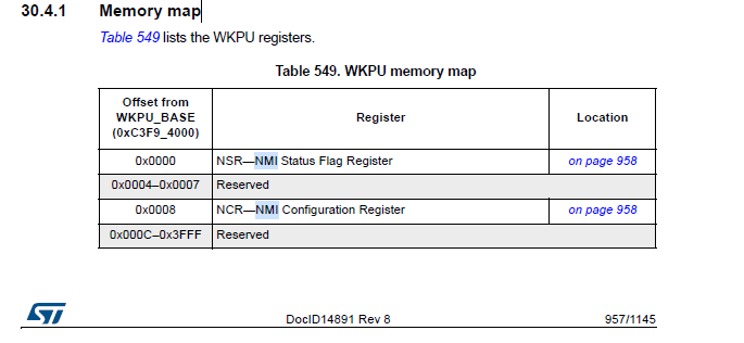

But the SPC560P dISP is not having below registers as per reference manual (Attached the screenshot)
  1. Wakeup/Interrupt status flag (Base+0x0014)
  2. Interrupt Request Enable (Base+0x0018)
  3. Wakeup Request Enable
  4. Wakeup/Interrupt Rising-Edge
  5. Wakeup/Interrupt Pullup Enable .. etc
My quention is that , wakeup will support in SPC560P Disp?

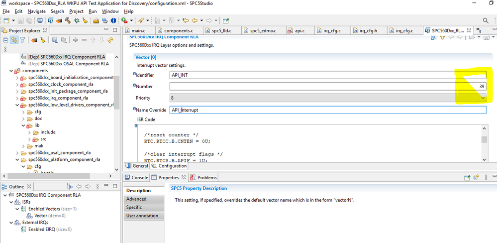

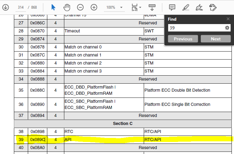

0693W000007Z5qFQAS.png0693W000007Z5pRQAS.pngFor SPC560Dxx MCU, IRQ number for API is 39, i got this information from reference manual ( For the suggested example code "SPC560Dxx_RLA WKPU API Test Application for Discovery " ). Please see the yellow highlighted portion of the attached screenshot for reference.
Similarly, What is the number to be configured for NMI in SPC560P50L5? . This information is not available in Reference manual.
Kindly suggest your input for this.
RatheeshT
Hello Erwan,
I got above information from datasheet.
Could you please let me know, which external source can cause Non-Maskable interrupt?
the RTC/API is not present in SPC560Pxx.
