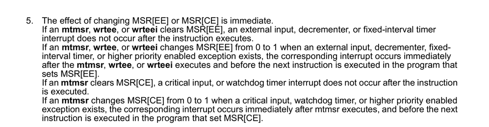

please do not call can_stop . there is an issue we are tring to understand
check here:
